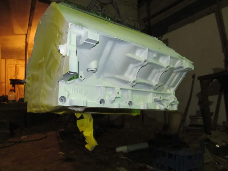

well , preping the block for paint last night , and painted the valve covers and coil bracket,
tell me what you think of the color, it is primer then red , then jut a touch of orange
