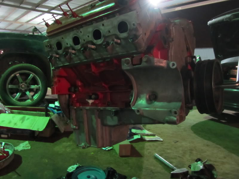

I already have OBX headers on the 5.3 will reuse them of course
some pics from yestrday, pan is on oil pump is in heads are on
