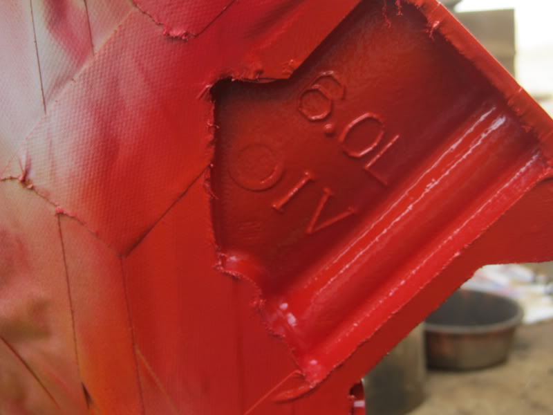

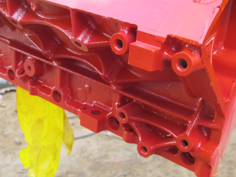

so what you think!!

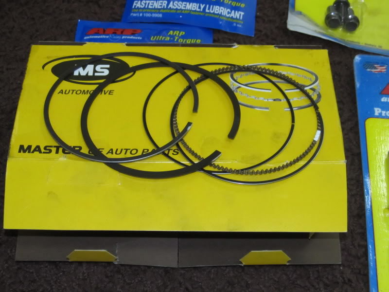

Definitely need new rings. They are a wear in place item, and it doesn't look like you're going to remember what place each one of them came from, being jumbled up in a bucket. Same goes for the bearings.
Block looks good though. Interested to see how it looks in the engine bay. Hopefully you can see it.

I bought the piston rings they are MS , an auto parts company from Raleigh NC, the reatiler said they are equal to /or better than OE quality
chrome rings and they look exactly the same as the OEM's
