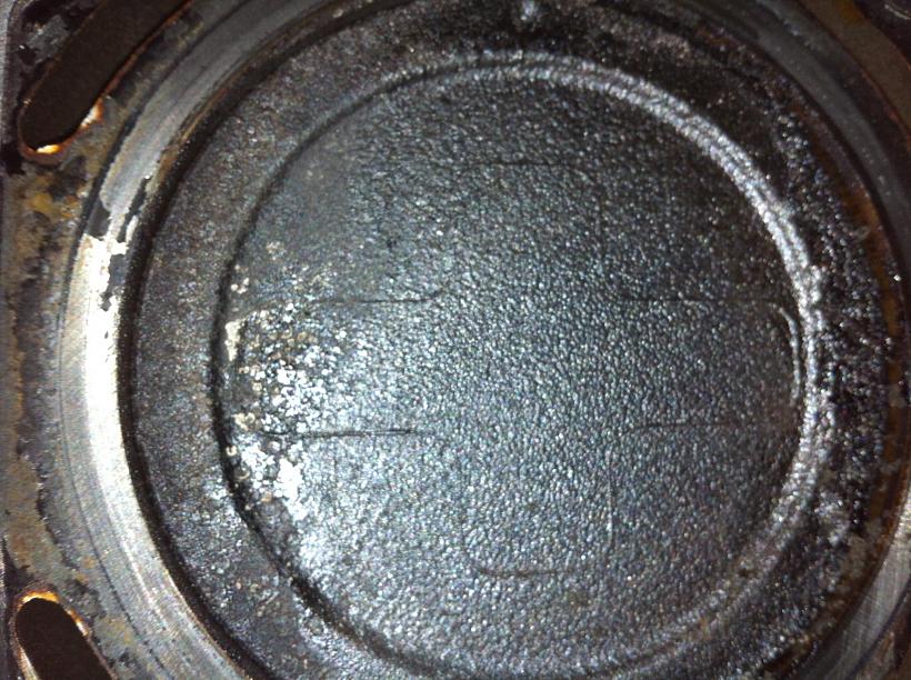

Hey I need help. I think the engine is not 5.3 it's 4.8 when I bought off the craiglist from the guy it say 5.3 off the 2002 Tahoe. I'd be upset if its 4.8 I don't like 4.8. It look piston show + that mean 4.8? Anyone can help me. If it is 4.8 how I able change to 5.3 or something?

Pics of piston? 4.8 will have flat tops in it. 5.3 will be dished, unless it is the aluminum block 5.3, then it has flat tops like the 4.8.

It look like not full flat top?

Look closer

Thats a 5.3 piston

Thats a 5.3 piston
You sure it's 5.3? What cam and heads should I get for my 92 s10

Yes that's a 5.3, its not a flat top....

Yes im sure

for what it's worth, if you ever do end up with a 4.8 and you want to make a 5.3 out of it all you need to do is stroke it...same bore, same block etc.
