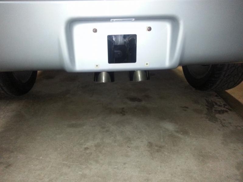

Two runs friday night at track. 1st was a 13.6 @ 106.5 2nd run trans broke. New it was coming though. Just not so quick. I was looking at the level 2 for mine it says it good for 700 rwhp. That should be enough i'd think.
Attached Thumbnails 3" pipes after headers no Y-20130925_212518-800x600-.jpg
