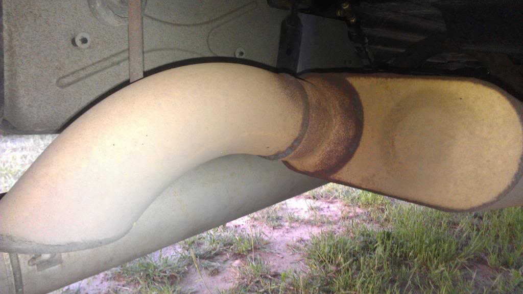

When I bought the truck a year ago, it came with a Flowmaster setup dumped before the axle. Someone was lazy...
After moving half way across the country towing my toy hauler, I've had enough of the drone and in cab noise.
This past weekend I went to the local junk yard and picked up a stock exhaust for the tail pipe section and ordered up a Flo Pro 2506.
From the reviews I should have a good system with no drone! Will also be nice to have the exhaust not dumping down on the axle while towing.
Thoughts? Suggestions?

Exhaust is done. The 2506 is dead quite inside the truck. There is a slight rumble outside on the passenger side of the truck. I kind of wish I would have gone with the 2504 for a tad bit more sound. But at the end of the day the DRONE is gone and that is really what I was after.
