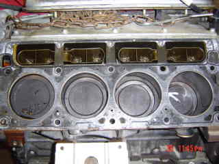

I would leave this blower at the stock boost 5.5lbs if I remember right. Unless you plan on getting LS1 edit and put a very good tune to it. Or just run a little paint thinner in your gas if you go to the track.
You will get KR anything over 7lbs on 80 and above days that is for sure and if you don't belive me on this look at these picts. 91 octane gas + 85 degree day + outrunning Lightening on the interstate = a broken #7 piston.
