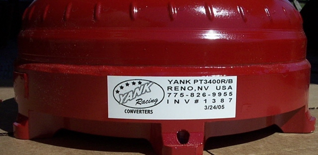

Does anybody knows by looking at the sticker in this converter for what set up is this converter for??? It was suppost to be for a 6.0 and 4L80-E setup but the damn thing does not alline right or something. I have my truck at Allen Nelsons place and I can't get it back cause of this problem. Unless I get a new converter.

is that the pro yank 3400 u have listed in ur sig? If so, i dont see the converter on yank's web page... is that one custom built?
Also.. the model numb starts off w/ "pt" i think it stands for pro truck... 3400 of course is the size of the stall... i dont see any part numbers on yank.. you can email them or call them tomorrow maybe.. im not real educated on them... also, there is a yank represenative on this site somewhere.. maybe he'll chime in, good luck with it tho.

Parish8 and L-Eater both had to redrill their flexplates to use that converter.I think it's actually drilled to fit a stock 4L60E flexplate for a conversion to a 4L80E.

This is actually the converter from L-Eater. But Allen got a TCI flexpate so it would fit but now there is a problem with the dowel is too short and won’t reach the crank/spacer/flywheel. Allen try it different ways with the spacer and without but nothing.
