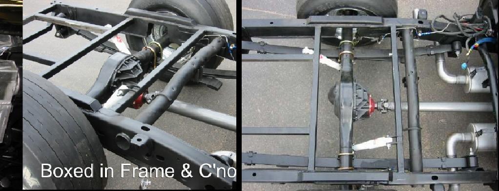

heres the clearance he had with slicks

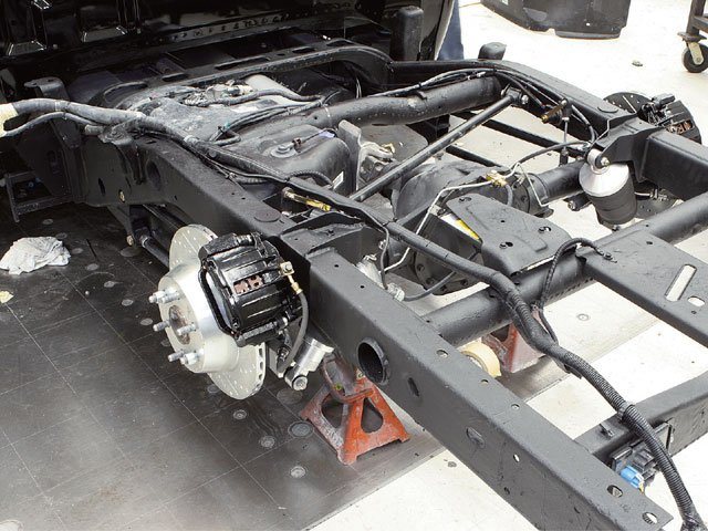

The first pic is with the rear end narrowed and the other one is with the leaf springs on the inside to fit a wide tire.
