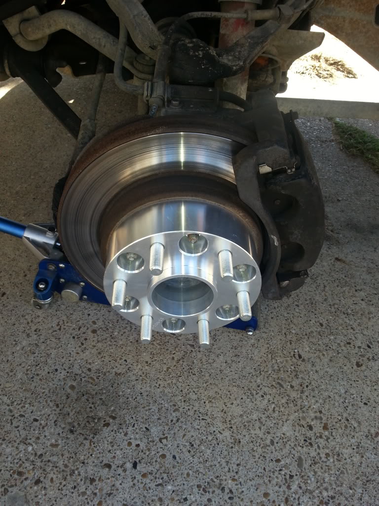

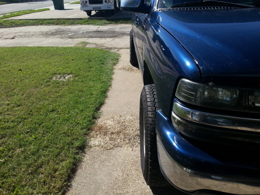

Heres mine with 2" hubcentric adapters with 285s on stock wheels... they do stick out. If you want flush, go 1" but make sure your wheels have the recesses for the stock studs or they'll have to be grinded down
