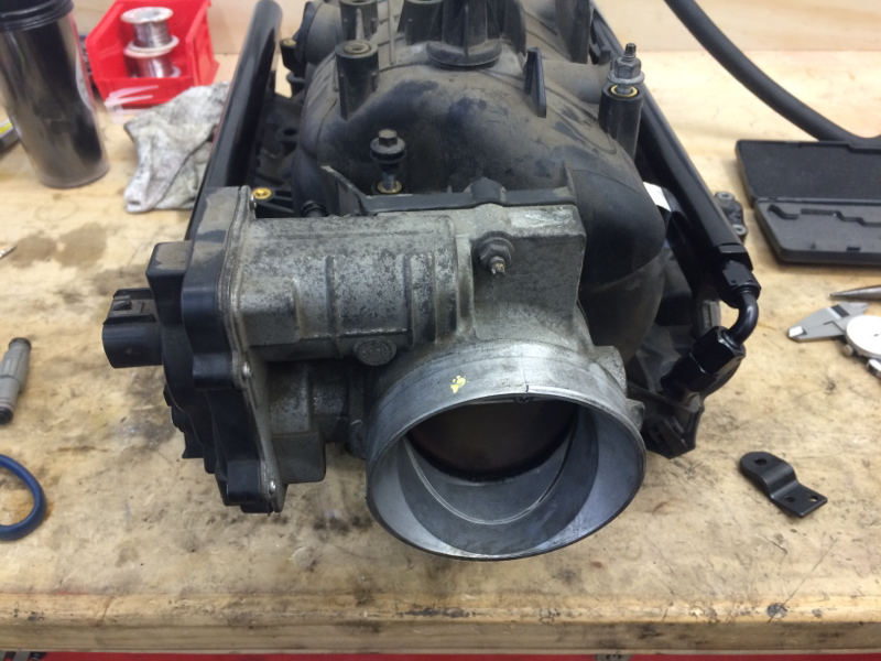

I was hoping to go 90 out of the drivers side and underneath the tb to the passenger side then out the rear on the passenger side to the regulator. ID Injectors in truck intakes-image-1257452930.jpg
Old Sep 1, 2015 | 11:22 PM
GMCtrk's Avatar
iTrader: (27)
Posts: 12,275
Likes: 19
From: Dallas
Going with the crossover over the TB will probably be a better bet than under.
You mean to avoid heat soak or just for space?
Old Sep 2, 2015 | 12:58 AM
GMCtrk's Avatar
iTrader: (27)
Posts: 12,275
Likes: 19
From: Dallas
Space
