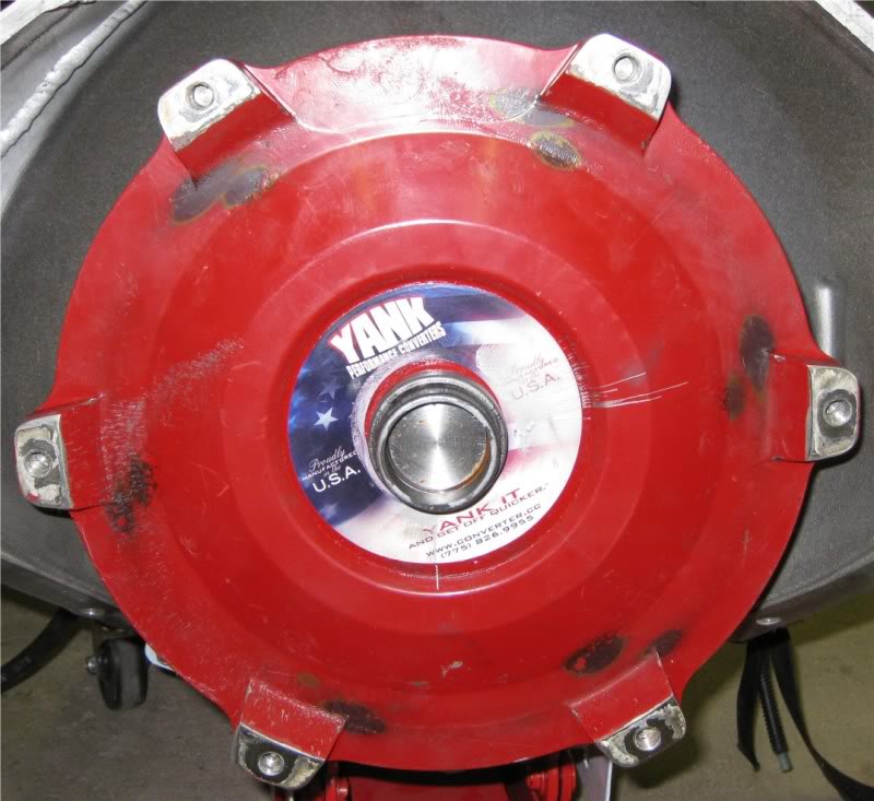

Even with my TCC tuned to only lock at part throttle, in 3rd and 4th, this is what my single disk looked like when I pulled the trans.

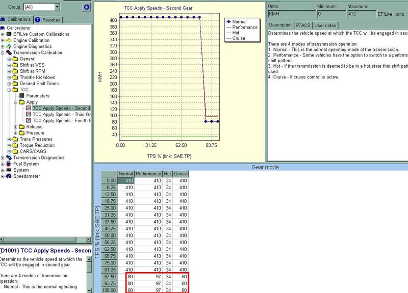

Also, there is a Gotcha in the stock 2nd gear lockup table. At first glance it appears that there is no lockup in 2nd, but if you scroll down you will see that lockup is commanded at WOT above 50 MPH.
