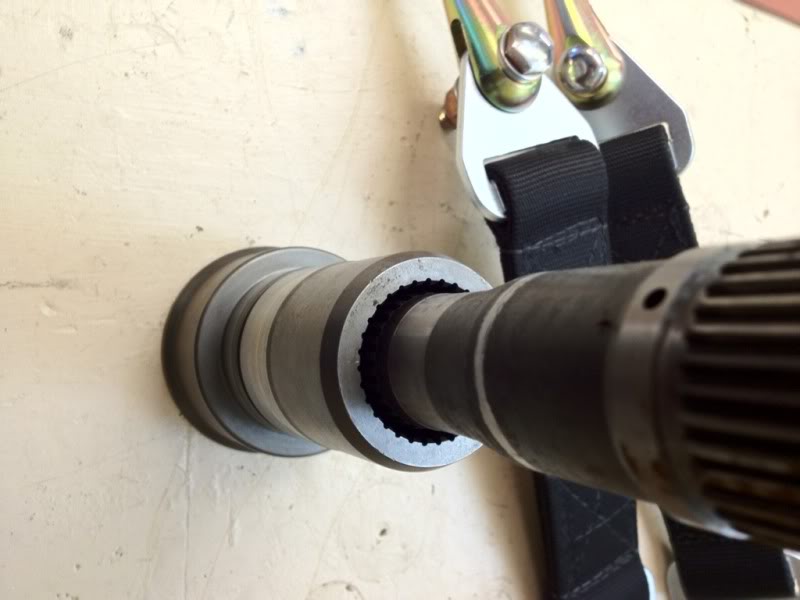

To compare, here is the 149 input modified for the 80e. The output shaft pictured is from a 65e. You can see the size difference.

The internals are very different. The 32 spline input off the 900 transfer case wont work on the NVG149 transfer case.
Mine was done by Time2Kill as well.
