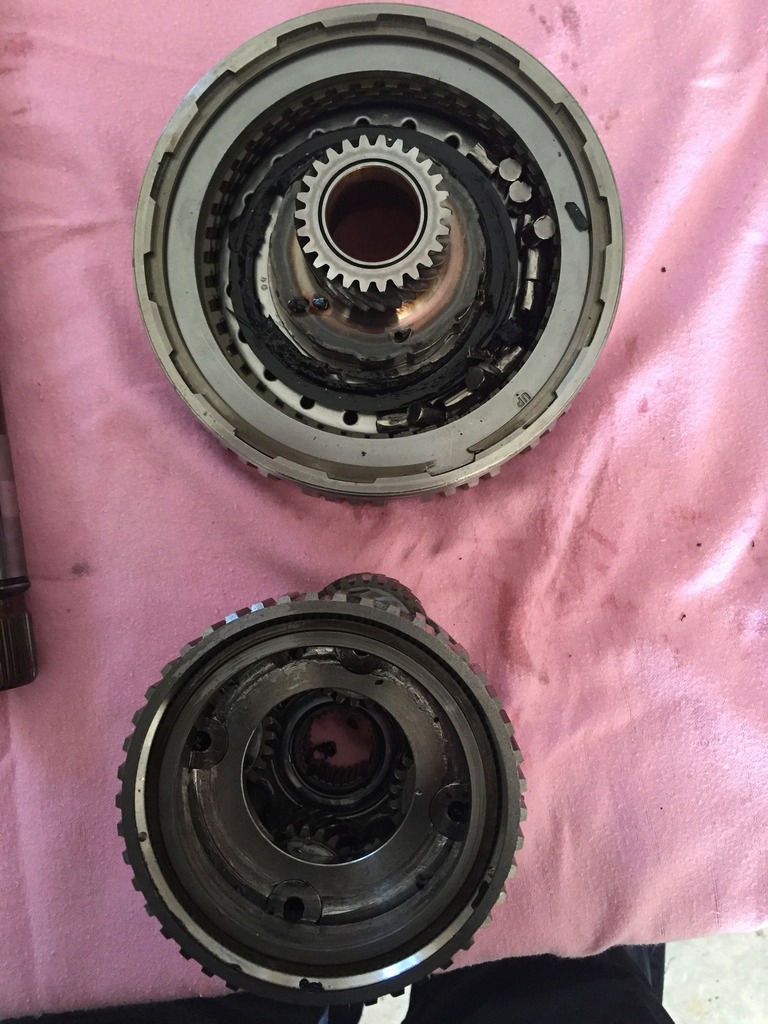

Ive recently learned a few things. When dealing with a turbo LS....
I broke my built 4l80e OD sprag assy. The reason this happened, I'm told, is that because I done repeated highway pulls with the shifter in the OD position the sprag wasn't supported and couldn't hold the power. If the shifter is in a manual gear selection, 1,2,or 3, the Overrun clutch assy is engaged and supports the sprag and is not as likely to fail.

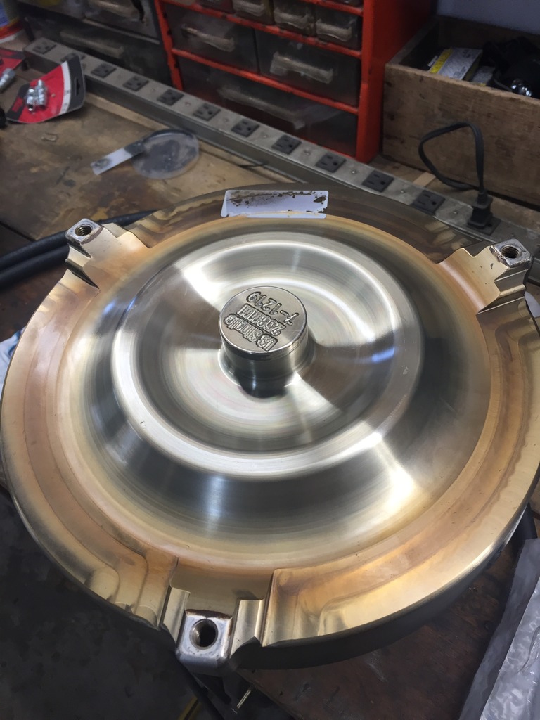

The other thing id like to share is my torque converter. I've destroyed the single disk clutch in m y converter due to the TCC settings. I was relying on the Base tune i got set up with from a reputable company. I didn't realize til now that it was set to factory settings and that was keeping it engaged when it shouldn't have been. The converter has been through over 20 dyno pulls, burnouts and street pulls. looking at the color of the billet front it has got really hot!!! SO, if u run a single disk and over 10# of boost i suggest u adjust your TCC settings so that its only engaged at low TPS or just in OD and set the disable TPS to where ever u start to build boost. I can build full boost at 30% throttle with a 102mm throttle body.
Maybe this is all common knowledge to the experenced guys but to all u new guys i just wanted to make u aware.

I believe all pulls should be done in d3 and burnouts in d2
Thanks for passing along the info

So you're saying you don't want converter lockup at all during WOT pulls? Basically adjust it so it locks in overdrive while cruising and light throttle driving? I'll also remember D2 and D3 selections when mobbing it or burnouts.
I just swapped my 4l80e in yesterday, this is all so new to me. No turbo on mine yet, but soon it will.

Originally Posted by Jake75
Ouch!
No!
Do pulls in d3, but when you do a burnout start out in 1st then move the shifter to 3 and make sure it's shifts to 3. If you let off when it's in second at high rpm it puts tremendous stress on the input drum since it sounds at double engine rpm the other direction.
When I do tunes I set the tcc to only engage in 4th at less than 40% throttle and unlock easily. I don't belive in locking it under power.
