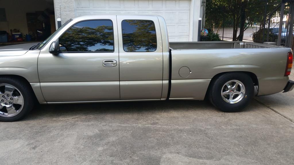

Done. Tucking 315s on 15s.
The problem was an internal clog on the caliper. I got another caliper from Advance and got fluid out of the bleeder as normal.

^holy damn...leg locked up. Also I'm confused...rear was converted to 5 lug?

Yes, i converted it to 5 lug.
I want to do 5 lug 15s on the front too but i dont know if they will fit with the 05+ brakes i put on recently. I may have to go back to the 99-02 brakes

awesome, looks great So how close did the 7.25 bs put you to the leaf. What drop is that in the back.

Its very close to the leaf. 6" rear drop. I would recommend anyone doing this swap to get the 295 tires at most. The 315s are very big on the 15x10s and would be better suited to a 15x12 or so.
