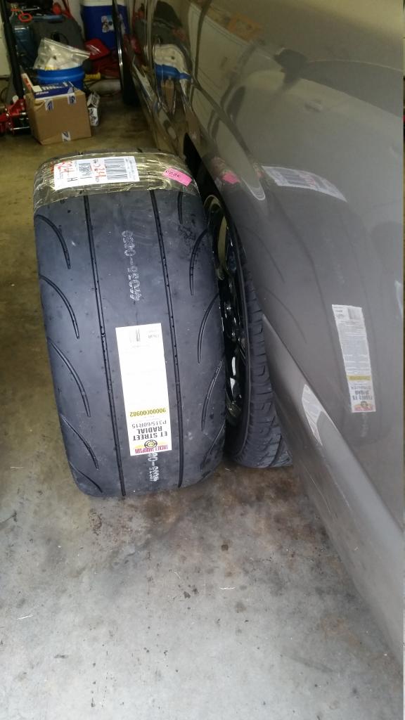

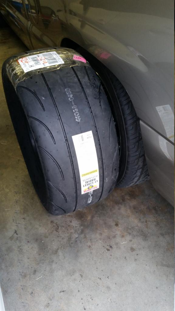

Now, the whole point of swapping to 5 lug is for the vast array of wheel choices and more economical choices. You can get Billet Specialty wheels for $250 each from Summit! As of now, Bogarts and Holeshot are the only companies I'm aware of making custom 6 lug drag wheels. Racestar is supposed to have a 6 lug 15", but who knows.
There are tons of choices out there for 6.5" backspace, however, in my case with a 6" rear drop (flip kit) I need more backspacing since I'm going to be tucking a big tire back there, the MT 315/60/15 DR. With a 28" tire, 6.5" backspace should be just fine.
Racestar 15 x 10 7.25" backspace are $183 shipped each off the shelf for the polished version, should work perfect for me. These wheels require shank style lug nuts, I plan to use McGard lugnuts.
As for the front end, I haven't exactly decided what I want to do yet, but 1320 wheels is offering brand new Timken hubs with 5 lug pattern for $219 each. A more economical option is for me to send them my stock hubs to convert for $90 each. I need to see if they can do them with 14 mm studs. Their site says they come with 1/2 studs.
I'm planning to do this swap next weekend, assuming I can get all the parts by then. The swap should be very straightforward. It involves pulling the axles out, removing the parking brake (this mode deletes the parking brake), removing the stock backing plate and bolting on the new custom backing plate and installing the calipers, pads, and bleeding the brakes. I do know that the stock brake lines will work with the OBS calipers, however, I plan to upgrade to the Russell SS braided lines.

Ended up going with the Racestar wheels. 15x10 7.25" backspace. Got the wheels and 14mm shank lugnuts for $348 shipped. Just put the order in for the 315/60 MT ET streets. Oakley is supposed to have the caliper brackets done by the end of next week. So hopefully I should have this all done within the next 2 weeks.
I really wanted to go with the Billet Specialties Street Lites but given the choices of 6.5 or 7.5" BS that wasn't going to work for me with the flip or 315s (7.25" is the max BS without hitting the leafspring). Beauty of the 5 lug swap is that I can change wheels easily in the future if I want.
