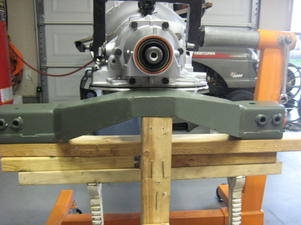

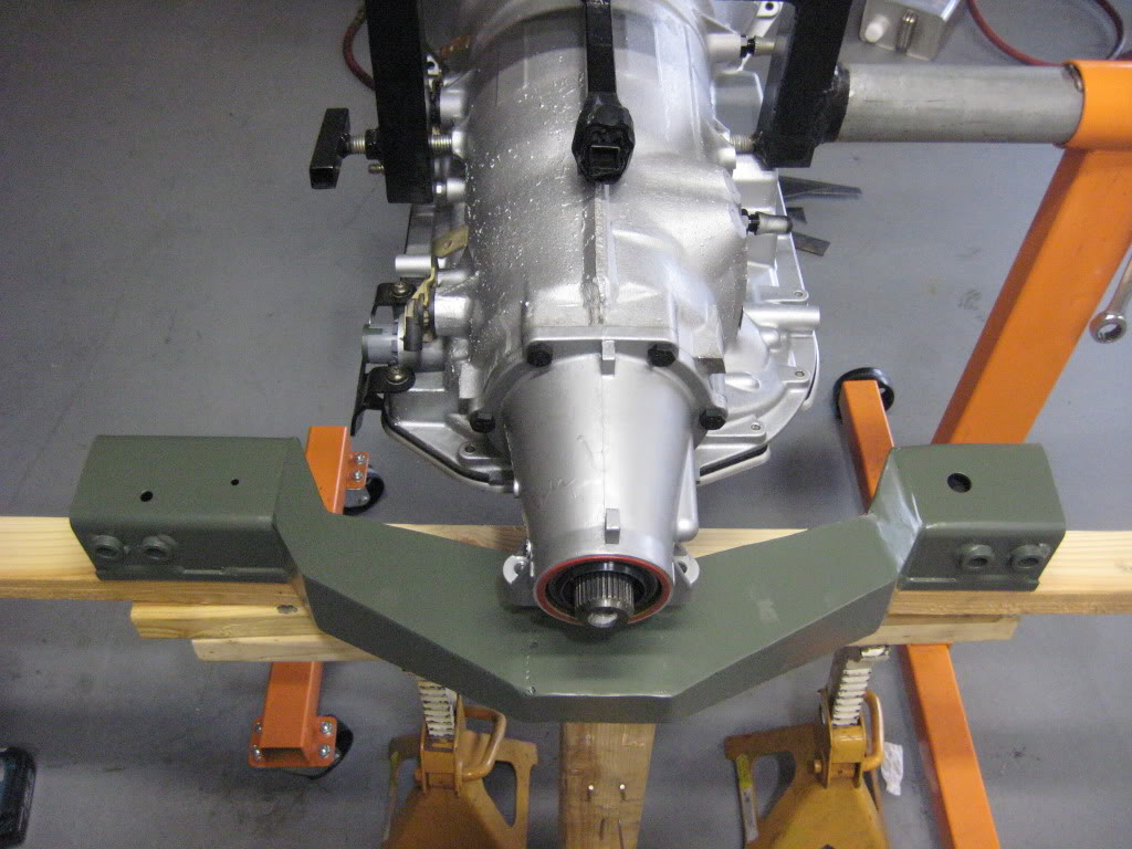

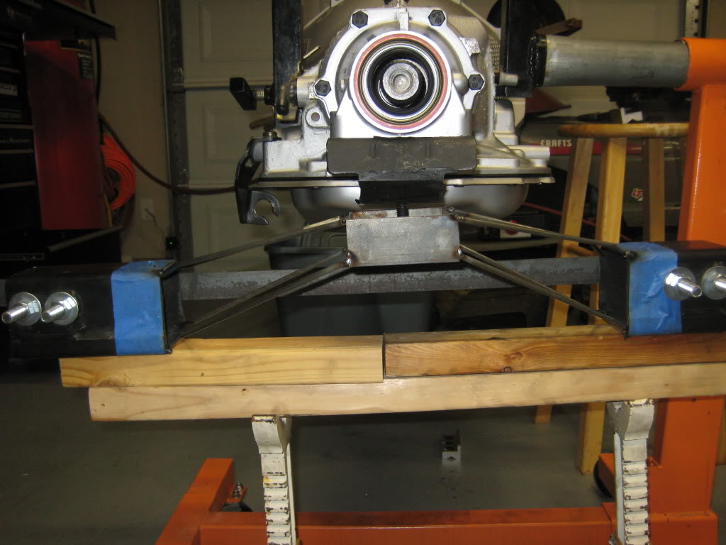

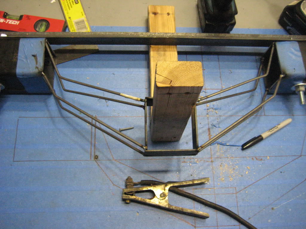

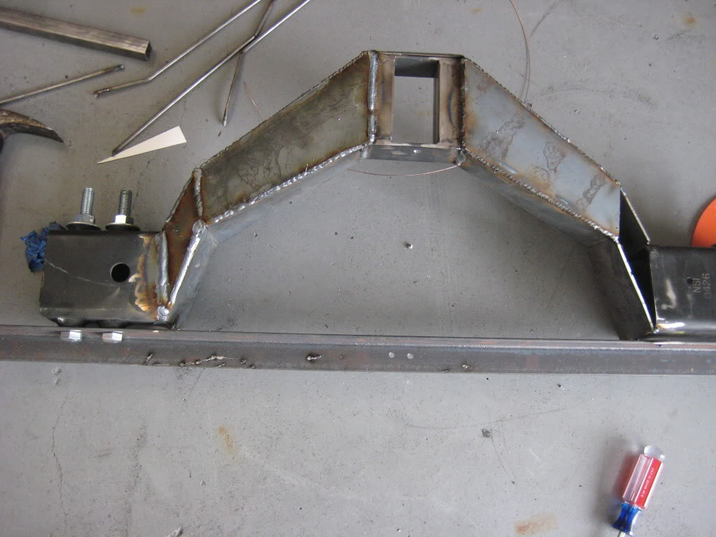

Here is the one i made

Corey, looks bulletproof.
Got any exhaust / header pics on what's goin on near there, cause it'd surely be custom I'd think?

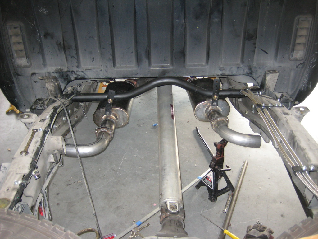

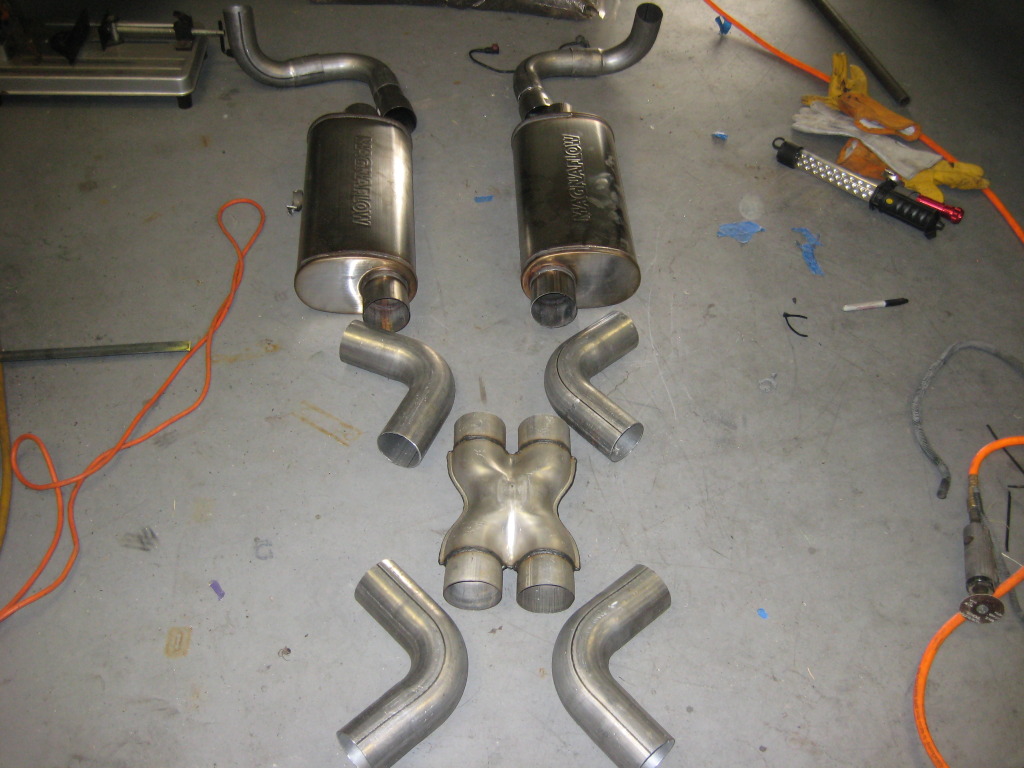

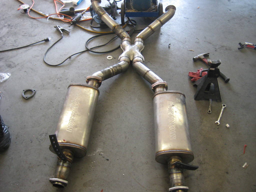

My exhaust goes under the crossmember.

Those are the only pics i have. Those pictures are not the finished product.

Further under cab, exh. nearest trans mount X-member?
Whenever u get some snapped, can u throw em up here too please, love to see em, finished or not.

Looks nice, simple and clean. Plenty of room for pipes to go under.
