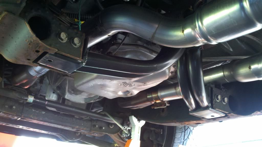

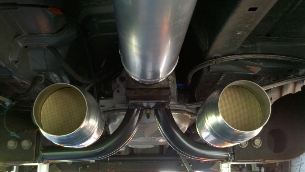

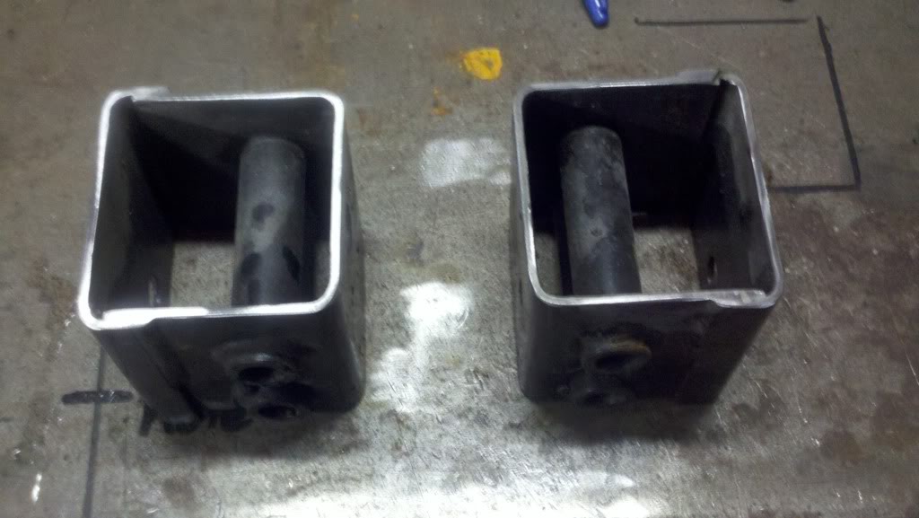

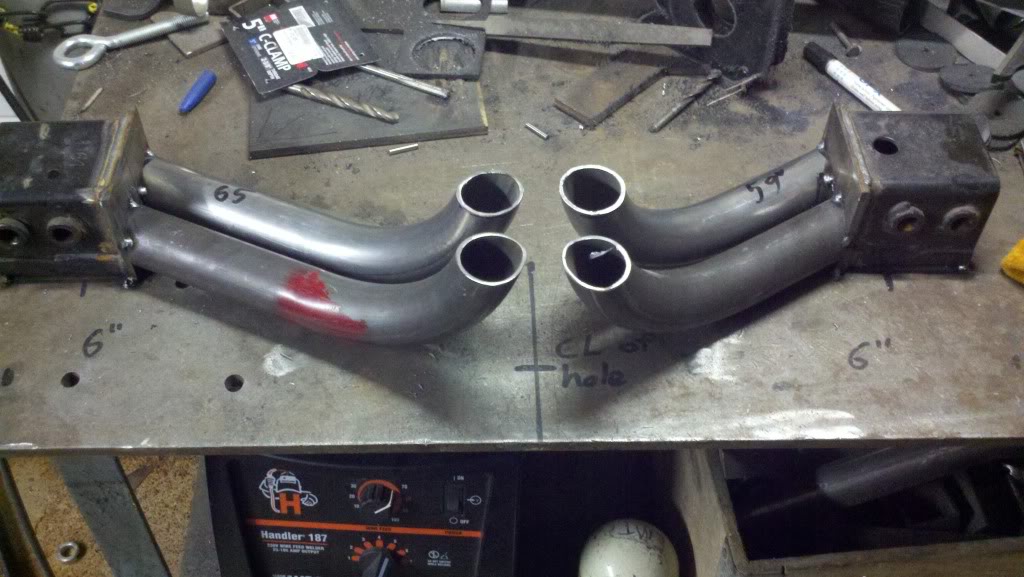

i made it myself. cut up the stock one, welded pieces in place to my table and bent up the tubes. I left enough room to be able to bolt on a driveshaft loop.
the biggest pain in the *** with this method is that its not centered, the numbers writen on the tubes are the degrees they are mitered to put them in the same position but with the left side tubes being longer
