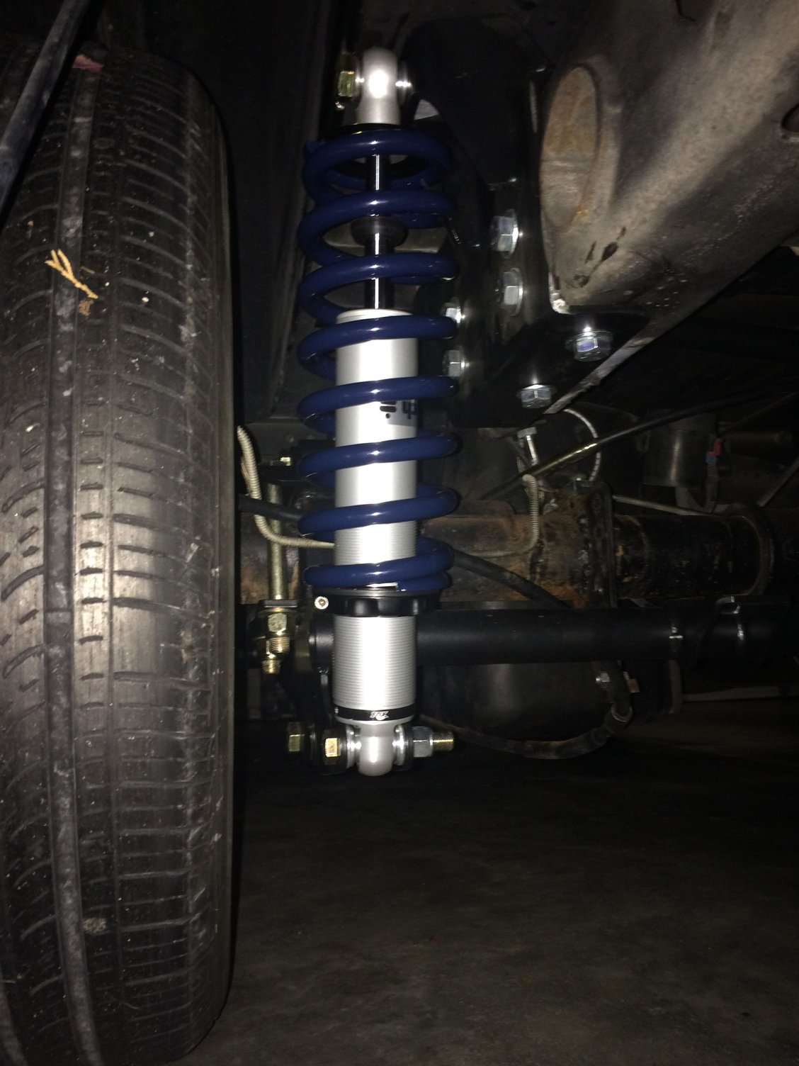

So I got the coilovers in and they ride great. So far so good, I'm loving them .

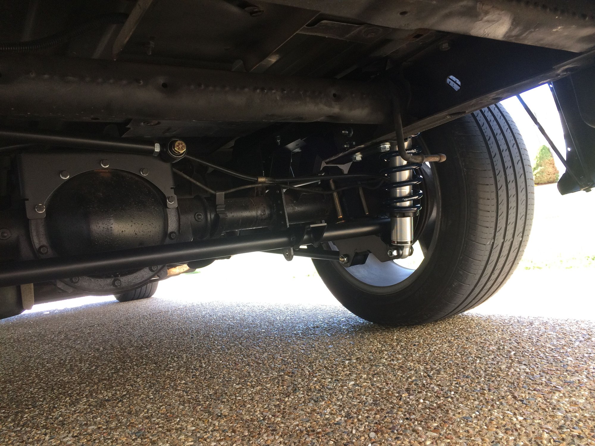

Just finished my 4 link rear coilover setup. Its a ridetech air bar kit that I used coilovers with.
Nice, I was wondering if this would work, I just happened to go all the way with mine

That's the complete ridetech airbag setup front and rear? Looks good?

Yup, with the upgraded 5 gal. tank and 2 compressors

They fit and actually have more room than I thought they would. I had to make some aluminum bushing/spacers for the top bolt on the back of the bracket. But other than that all bolt in. Ridetech stuff is top quality. Now I just need to save some cash for the front.
