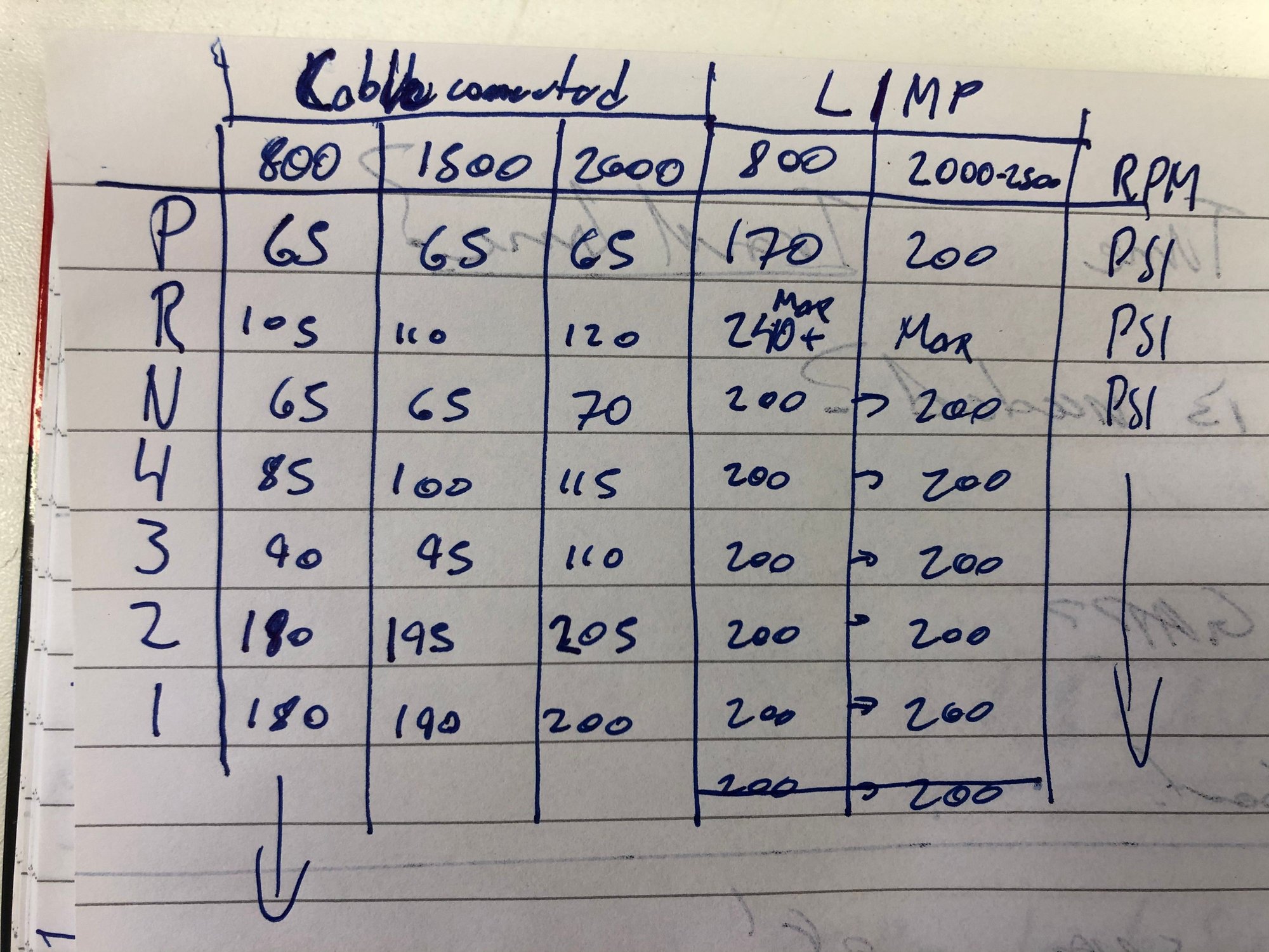

Pressure according to picture, when increasing pressure in TCU 3rd and 4th increases as well. Most things checked more then twice..

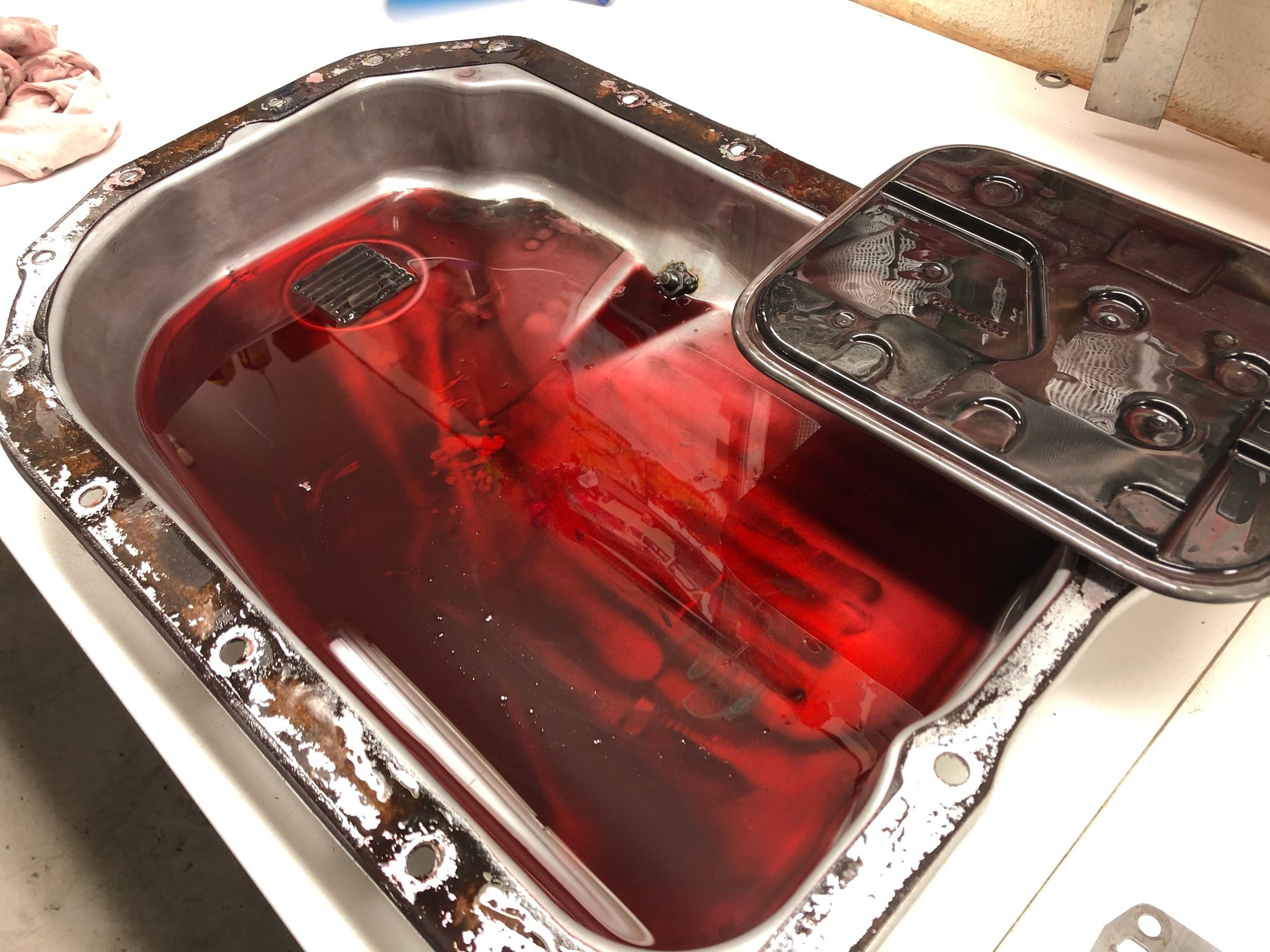

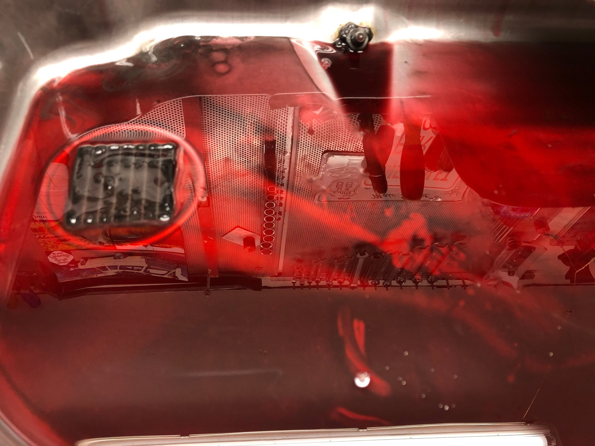

Just dropped the pan, what do you think about this? Too much or worth a try?

Checked pressures during shifts, 170-180 psi, not drops, even when slipping.

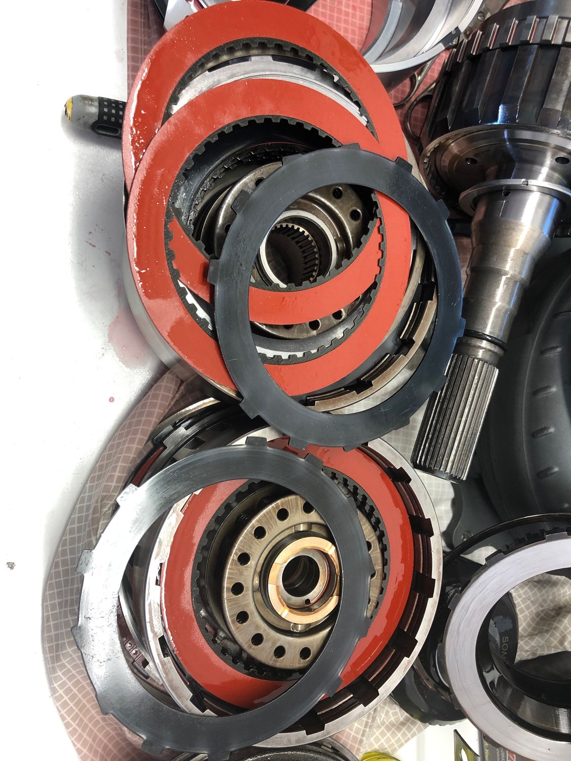

Took the transmission out and disassembled it today.
I can’t find anything that might cause this. Any expert that can help me figure this one out? @MaroonMonsterLS1
All clutches and steels look fine. Measured the direct and forward clutch pack clearances and they were about 0.012inches from what they were when they went in.
So, missing first in manual low, starting in second. Not staring in first gear in gear selector 3 or D as well as slipping.
Have pressure and do have air tight clutches.
Experienced some leak in the direct, my drilled hole for the centrifugal apply fix leaked, I punched that together to rule that one out. The ball valve might have been slightly leaky.

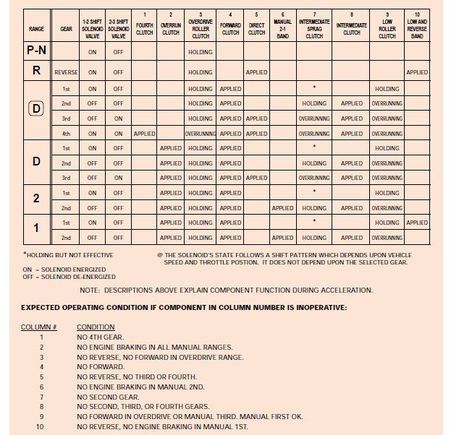

I don’t dare to believe that was is so I did some testing on the valvebody circuits.
All electronics but the harness is new and the solenoids are tested. All sprags are in right direction.

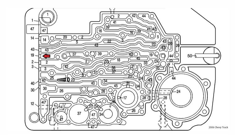

I assembled only the VB and servos to the case. I put air supply to channel 2 in the case and blocked of some other passages leading to the pump.
If I understand it correct passage 2 should be oil supply. With this I tried running thru all shifting options with the solenoids.
P/N seemed to work fine. No difference on solenoid A energized.
Reverse worked with both reverse band pin moving and direct air in the case. Solenoid A did not do any difference.
D, when both solenoids off, forward clutch air, intermediate applied.
When energizing solenoid B direct applies.
When energizing solenoid A, nothing happens.
When energizing both, same case as for solenoid B energized.
Solenoid A is just clicking and sitting the solenoid leak but nothing happens..
​Same for the other gear selections and combinations. Including manual low where front band and intermediate stay applied and rear band unapplied even if solenoid A is energized.
Is this a valid test method and what could be wrong?
