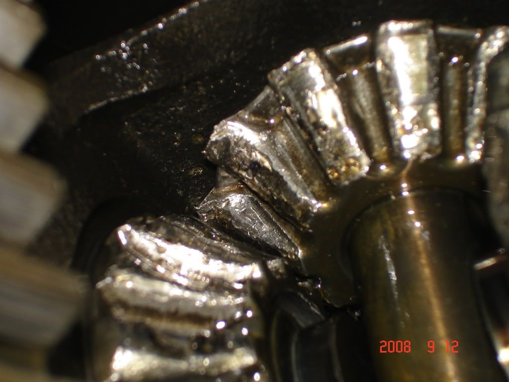

Mine was making noise too...
That was a great write up 00ChevyScott.

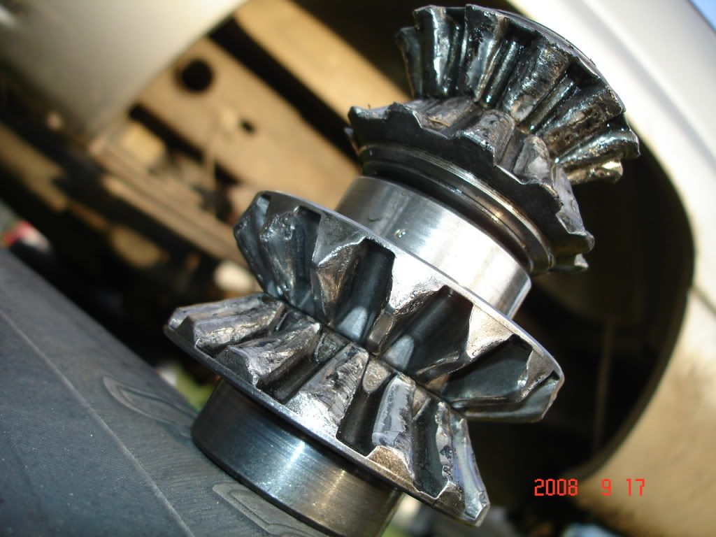

One other thing to make sure of is to CAREFULLY inspect your ring and pinion. You want to make sure none of the pieces got ground up in the other gears. Though, if you've been driving like this for a while, they may have. If you have the money and/or time to do a gear swap and a new LS carrier, it's a really good idea.
That's what I decided to do with mine, I figured I'd go ahead and eliminate all of the possible problems that the 10 bolts are prone to.

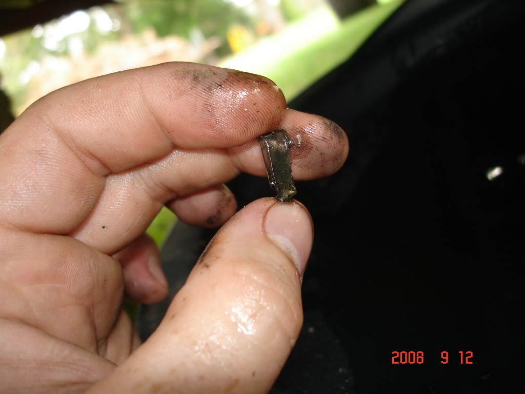

The post above by 00ChevyScott is right on about what you need to do. I'll just add to be a little careful when removing the pinion shaft lock bolt. If it feels like it's coming out hard, work it back and forth a little. Most of the time it screws rite on out, no problem. Every once and a while though the pin portion of the bolt that engages the pinion shaft will snap off. If it does, it's not the end of the world. The pin it pretty brittle. You can take a big drift pin and a hammer to drive the pinion shaft through a little and rotate the carrier 180 degrees and pull it out. If it damages the pinion shaft you will have to get another one and of course a new pinion shaft lock bolt. Good luck, I'm sure you can handle it without a problem.
I got everything apart, very simple like you guys said.
BUT, i believe they sent me the wrong gears. they are not the exact same as the ones that came out.
on the gears that spline into the axels the "ribs" that actually mesh.
stock - they extend vertically from the bottom plate about 1/4", then they taper in towards the center
Summit - Ribs extend outward for 3/8" then taper in towards the center. total heght about 1/4" taller then stock
I noticed then when i could not put the C-clips in. it doesn't appear that the axel will push in far enough to allow room for the c-clip. perhaps if i didn't put the thin washer in that comes stock and they give you...
anyone have this issue? is it an update, or did i get the wrong parts?
2000 1500, 10 bolt rear.
EDIT - they are not the same as in the picture, the picture looks like stock. they are black and slightly larger....

They sent you one for a 8.5" 10 bolt rear, you need the ones for the 8.625 (99+) 10 bolt. I'm suprized they are different, as the ring gears on the 8.5/8.6 are the same size. I would call up Summit and tell them that they messed up and have them ship you the right parts for sure this time. You did order the ones I linked you to on the other page right? Be sure and tell them it is the 8.625 in the 99+ trucks.
