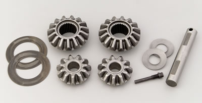

spider gears are out.
You can pick those up for 100 bucks and the install is easy as cake.
EDIT: well they went up, theyre about 130 now from summit
http://store.summitracing.com/partde...5&autoview=sku

This is what mine looked like when I did it the 2nd time haha

It all depends on how much money he's got and what hes capable of installing.
Spider gears are cheap and the install is easy and requires no re calibrating the rear ring and pinion.
shift grind, if you have the money to pay for parts and labor on gears and locker, do it. But if you're on a budget, just replace the spider gears.

Spider gears are toasted..
