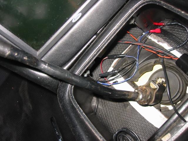

Here is mine. THe only wireing I hooked up was the speed sensor. I didn't even hookup the reverse lights.

Old Dec 22, 2006 | 03:45 AM
TURBO8's Avatar
Joined: Apr 2005
Posts: 872
From: San Francisco Ca
What I did was take the front bolt from the front seats and drew a straight line across. From there I just measured 3-4 inches forward, in the center of the transmission tunnel is where I started my hole. I started small and worked my way to where it is now. I had a friend of mine get alittle crazy with the cutting wheel and he ended up makeing the hole alittle bigger than needed to be.

yeah i found a picture of 1truess's shifter, he has the same shifter as me, im gonna try to start about in the middle of were his is and just work from there. Thanks for the quick response and yeah i think i am just gonna stick with the speed sensor and nothin else.
