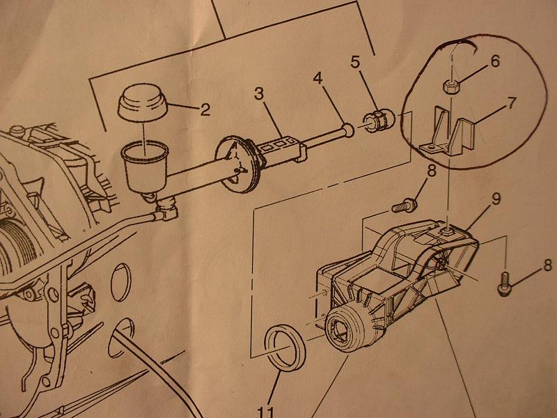

And as far as the stress applied to the truck master cylinder (cracking in half at firewall) I have a theory.....
The bracket circled in the picture I attached is nearly impossible to see, let alone install. This bracket (not factory installed on auto trans equipped truck) looks like it would relieve some of the stress on the firewall. Actually it looks as though it is there in 5 speed trucks (microfiche picture is of 5 speed) for that specific reason.
So my question is, how do you install this bracket?
This question if for those who have put a 5 or 6 speed in an original auto truck.
ill agree the pedal housing flexs alot. but i still think it will brake. only think i can think of is making a still plate on fire wal. this way i can reuse the other 2 pedals i have lying around lol
It needs to be welded in. 2 small spot welds did it. I had the dashboard removed from the truck.
Thanks...I figured that is what needed to be done. However, I was able to bypass that step in my T56 conversion.
I simply made a 1/4 thick flat steel bracket on the outside of my firewall (under the hood) for the two bolts on the pedal assembly. It is very strong and I have slammed the clutch pedal pretty hard and it only flexes a little bit, but it does flex. I recommend removing the dash+spot welding the bracket like Dokta says, but if you want to save some time and hassle just fab up a bracket like I did.
Since completing my T56 conversion I am addicted to driving my truck everywhere! Gonna make a trip to the Dyno here before Winter comes.
