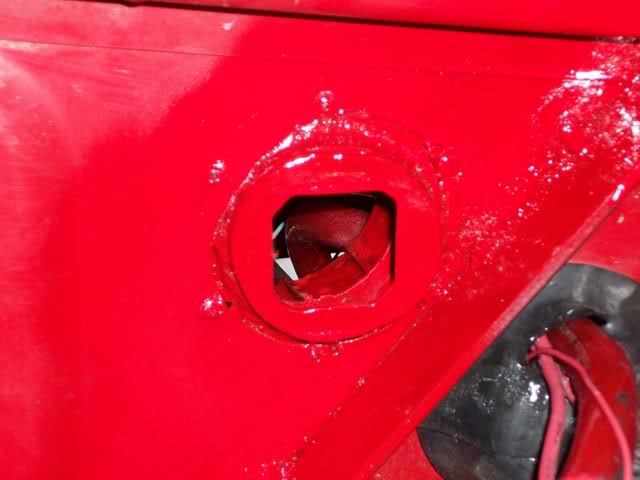

word to wise. the stock pedal assembly is a bad design. if you put any type of stiff clutch in your truck. you will push your master thru the firewall. this is my 2nd pedal that just broke. i had to be towed home cause the square hole busted out. bfore you do this swap reinforce the opening or else stock up in these pedal assmeblys
#567
#568
Here are some pics of what did so solve the problem
