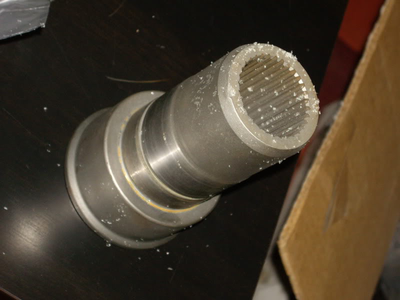

Nah the nvg149 input is different
There is no stock replacement for it that is why you have to get the resplined one from EAD performance. It's a lot more expensive than the regular 4x4 input as well.

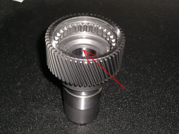

4x4 input for reference

thanks black04 yes its the input gear im looking for.

ya that is way different, weird, cause i think somebody in the thread called that a nvg149 input.
