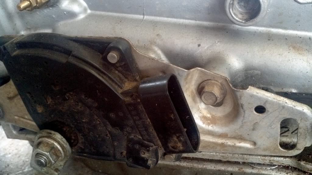

(4) where can i put the sensor for the trans temp? i see it doesnt have the same port as the 60E has
Thank you for your help

Just use the stock neutral safety switch off your truck. PCM reads trans temp so you can monitor it in hptuners.
I used the new triple plate in mine but I know some people do it differently.

ok about the neutral safety switch
i wont always have the lap top in there so i kinda would like to still use the gauge too if its possible
did u have to change anything else then drill AB and C? on the new TG plate?

I just drilled them like the instructions said.
Could also do like a aeroforce scangauge or something to monitor trans temp. Thats what i have in my truck.
