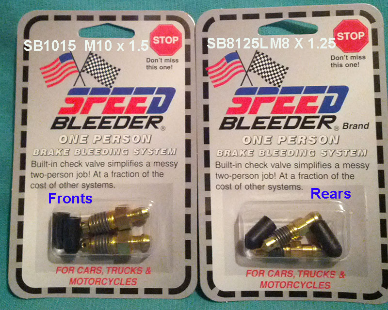

The 2005 Silverado Rear Drum Brakes Speed Bleeder Part Number Story
I wanted speed bleeders. Sometimes I heat em up so twice a year I bleed them. The rear wheel cylinders are brass or the like and if you let them go too long you will see dark green fluid on your first few peal pumps.
So I go to RockAuto and theirs are Dorman, and the description shows "Without Orange Dot" Huh? No one could say what it meant but my wheels as seen in the pic above show Green Dot markings. They are on the tips of the lugs, the cylinder, the adjuster and elsewhere.
So I order and the rears will not take thread. The fronts will only catch two threads because the valve seat tip is too long.
I call Speed Bleeder. Other than them not being aware of the Changes on the 05 brakes they were SUPER HELPFUL. Great people. Now they know about the drum rears.
They had me give them some info and then fill an order for what I needed. They don't usually sell to the end user but this was a new case.
Below is a pic of what you will need for a 2005 type of braking system speed bleeders. I edited in the part numbers from the back of the packages and the front and rear titles.
I suggest you go with Speed Bleeder brand. There are Chinese knock-off that have failed. The tell tale is the sealant color. Speed Bleeder uses the silver or gray looking. The others use Red-ish or White. The Dorman packages clearly were marked China.

Thanks, Basically I wanted to point out that Raybestos's Best drum still needed cutting.
And Part 2 was to help others with getting the correct speed bleeders if so-desired.
If you searched Speed bleeders application chart you would get the wrong fronts and no rears.
If you searched Dorman's p/n's or RockAuto you would get the wrong fronts and rears.
All the above due to GM's Brake System Change for the 05 Silvey.
