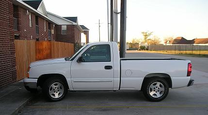

Yeah what's up the the drums?! All I could find in Texas was one with 3.23, hoping to switch to at least 3.73's. Will a hypertech get rid of the torque management and all the other bs, or do I have (need) to go with a custom tune? I read the manual and I don't have the button to turn off the traction control.
