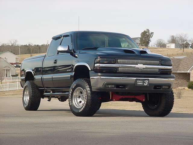

Att. is a pick of the truck we are doing the work on. Thanks for the help
