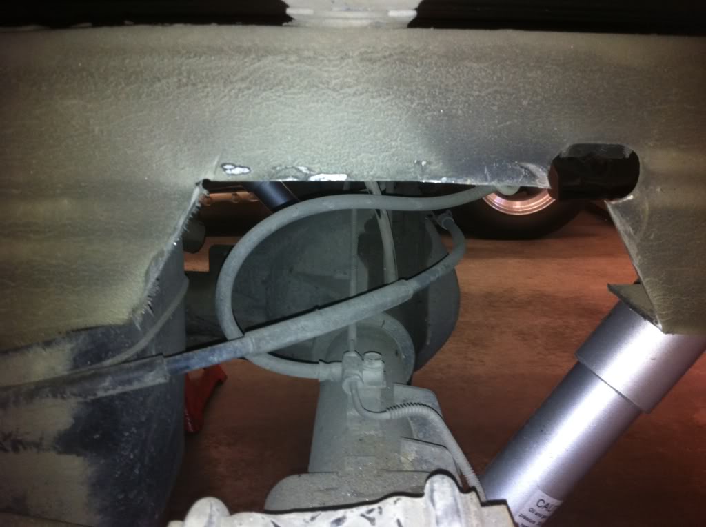

There really is hardly any room between the axle and the bump stop (See attached pics.) Also I don't have shock extenders (Pics below show shock angles.) Ok now two questions.
1.) Considering the pics does it look like I should get a notch kit and/or shock extenders, and/or new shocks?
2.) I could see how the notch kit might help but ultimately the way the rear bounces over bumps is just ridiculous. As far as the notch kit goes isn't that mostly to address frequent bottoming out? The truck doesn't have so much of an issue with that, and more an issue with insane bouncing over bumps. It almost seems as if the shocks are blown, and really aren't doing anything to control the bounce. That's why I was thinking that possibly new shocks would help really address the issue.

Yes, get a notch kit, and the shock extenders. You should be good to go after that.

Cool. So sounds like the Belltech notch kit is the way to go. Also how difficult is it to put in the notch kit? What tool would you recommend to cut the frame and does the notch kit just bolt in? Thanks for your help!

I use a cutoff wheel on a right angle die grinder. You could use a sawsall, or an angle grinder. The Belltech is a bolt in kit, and not too bad to install.
