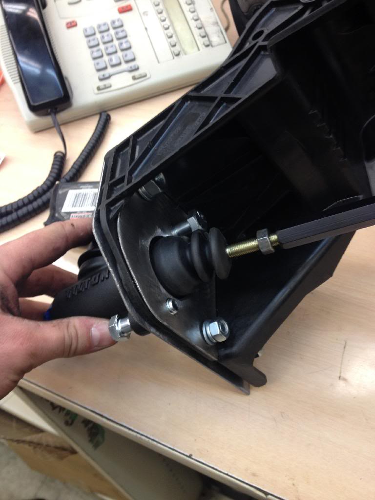

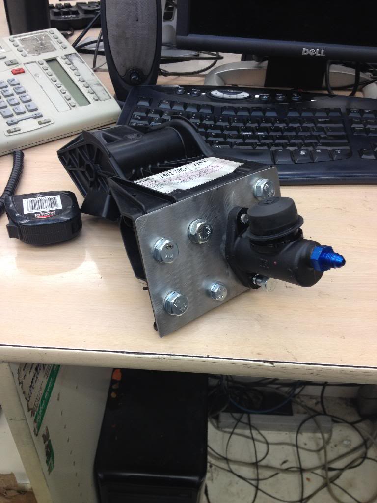

Once I go get it in I'll se e whch way works best. But I've always done on trans install
This is a t56 magnum, so it's brand new no core. Level 6 with the clutch flywheel and shipping to NY was $7000
I appreciated the input on the master. However, being all click together plastic, and the fact that I already have everything I need I'm staying with this. The way it's gonna work will be much atronger then oem. Basically using steel plates and 4 bolt holes to hold the pedal to the firewall, then the 2 bolts holding master to all that.
Difficult to explain, but you see. PLUS I'm going to have an adjustable master which will be sweet

That's a grey solution you made for the pedal. I'm basically cutting that whole piece off so the pedal bracket sits flush with firewall, eliminating that plastic that a oem master clicks into

Had an opportunity to work on my clutch pedal assembly. Its ready to go in, just need some tweaking once it goes into the truck.

Gonna paint inside plate satin black, and having outside plate colormatched

Trans is in. mocked up a cross memeber. The 99 has a much smaller crossmemeber then the newer one from a 5 spd i bought.
Had to buy another clutch pedal. I Cut way t much material off the other. The plates are still gonna work, but Im gonna cut half of the firewall one out. I made the plate at work before i really had a good look at it. O well, mistakes happen.
