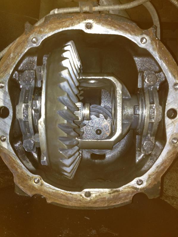

Post a picture of your truck, and a pic of your differential. Did you count the splines on your axle?

This is what I have. I also have disc brakes.

It is an open carrier. I don't know what the differences are from the carriers used with the 8.5 and the ones for the 8.6, but the gears and mini spool I tried like I said were for an 8.5 but were too big. I talked to numerous tech guys and even contacted the GM dealer that I bought the truck from and they all said that I had the 8.5 set-up. It would be one thing if only one of the parts didn't work, but I have 2 products from 2 companies and neither one will fit.

You don't have an 8.5, that is an 8.6, and I don't believe there is a mini spool that will fit "off the shelf".
