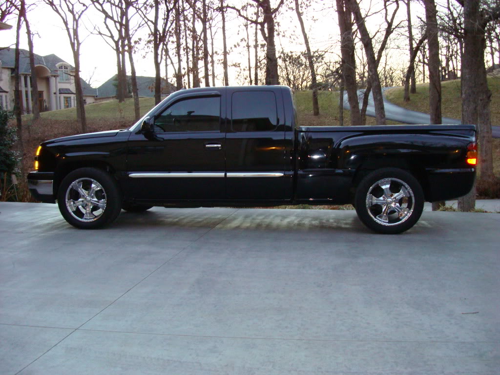

De-cranked TBs, removed block, and 2 inch beltech shackles. I have the beltech performance shocks in the rear and I'm about to get a set for the front along with the beltech bumpstops.Tire size 285/50R20
Pic was taken on my driveway which has a slight incline plus there might have been air in my tow bags
