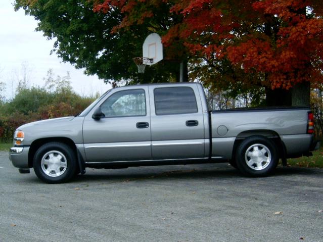

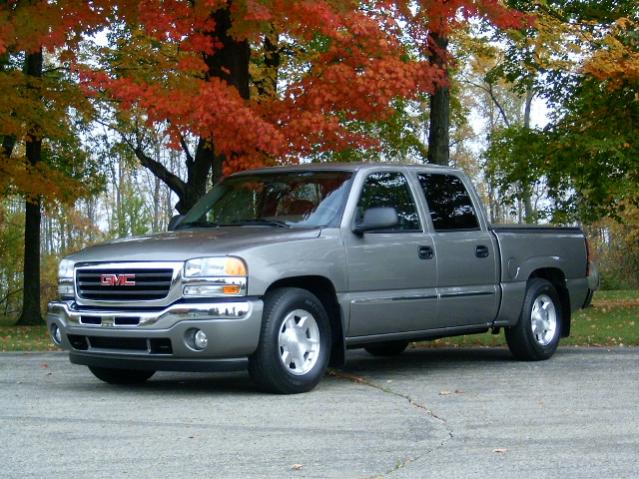

I have the 2500 keys turned down for a 2.5" drop up front (with modified stock bumpstops) and the lift block removed + Belltech shackles in the rear which only netted me 3.5" drop ( I was shooting for 4"). Stock shocks with extenders on the rear, rides like stock, no excessive tire wear in 9K miles since drop.
FWIW, I initially turned the front down 3" from stock but the alignment shop ran out of adjustment for camber and had to turn them up 1/2" to get it within spec. If I had it to do over again, I'd go with 2" drop spindles and adjust from there. Also, I lost some turning radius after the drop - it reaches steering lock sooner than when stock ride height, notice it most in parking lots...
For the OP, you're right about the CC's being limited in how much we can drop the rear 'cause of the welded spring hangers. I'd like to drop the rear another 2", but mine is a DD and I tow with it so drop leafs are out of the question for me. Most I'm considering doing is removing the overload leaf and adding an airbag system to compensate when in tow...
Attached are a couple pics of results, prior to removing the mud guards (truck is Z71 and previously had Dueler A/T Revo's). Tires are 275/65-17 Michelins...
(Right Click "Display Image Full Quality" for clearer pics)
