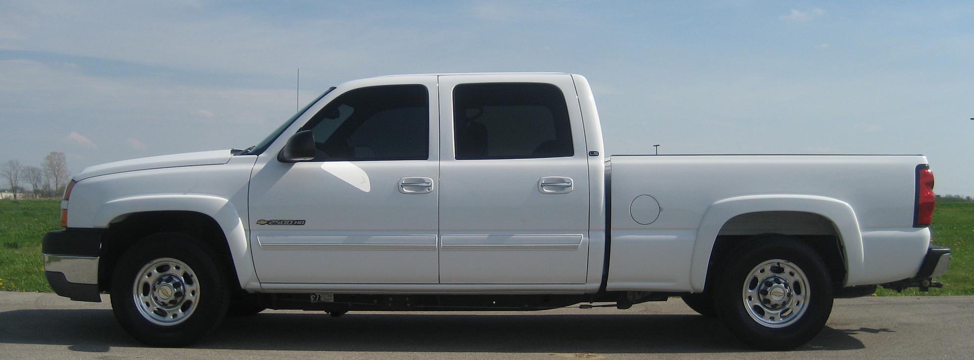

My 2005 2500HD 4wd is dropped 3/5 with a DJM kit.
In the rear, I have C-notched the frame for more travel and spot for 2500# bag.
On the rear spring pack, I pulled the third from top spring. Next I'll probably pull the overload spring because the bags compensate for it. I read where other guys have done it without any adverse axle wrap issues.
Attached Thumbnails Lowered 1500/2500HD guys...-maddox-truck-4-09a.jpg   Lowered 1500/2500HD guys...-img_0462.jpg

wow truck looks good 2500HD! I guess the only problem I have with trading for one now is the wheel options are few and far between haha
