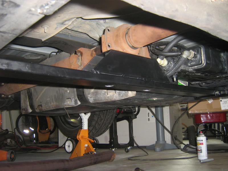

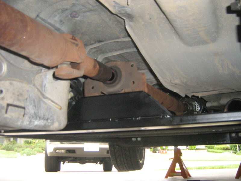

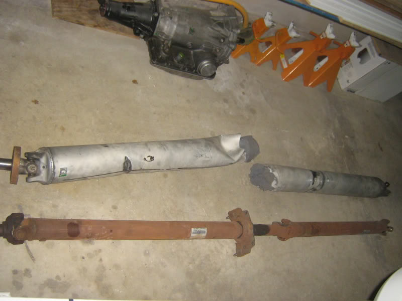

I blew up my one piece at the track and used a ECSB 2 piece.

I had to do a couple of changes to make it work but I wanted to keep as many parts fatory GM as possible.

The crossmember was removeable and I set up the u-joint angles to work with my 6" drop in the rear.
This is what i was looking for. I was wondering how far back the crossmember had to be as I was seeing it was close to the fuel tank. Thanks for the pics. Did you have to do anything special as far as driveline angles? I assume just build the crossmember to suit your angles? Correct?
Old Dec 24, 2012 | 02:00 PM
blue2003ls's Avatar
Joined: Oct 2007
Posts: 496
From: Roseville, CA
The centerline of the carrier bearing is 45" from the face of the transmission crossmember and everything else falls in place from there. Luckily I had an ECSB to take measurements for comparison. From what I remember I had 2.5 degrees for the u-joints and 5.5 degrees at the pinion. The only rework I really had to make was rotating the Evap canister similar to how the ECSB.
