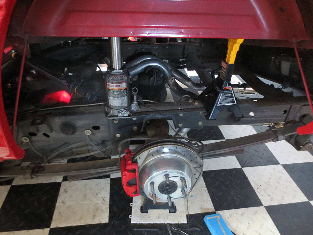

Just do the bolt in notch's in an afternoon and enjoy the total drop.
(bed lifted for fuel pump replacement)
Just did 3/5 drop and need tire recommendations-jsbwji0.jpg
what notch is that?

Looks like a McGaughys notch... same one I have 👍
