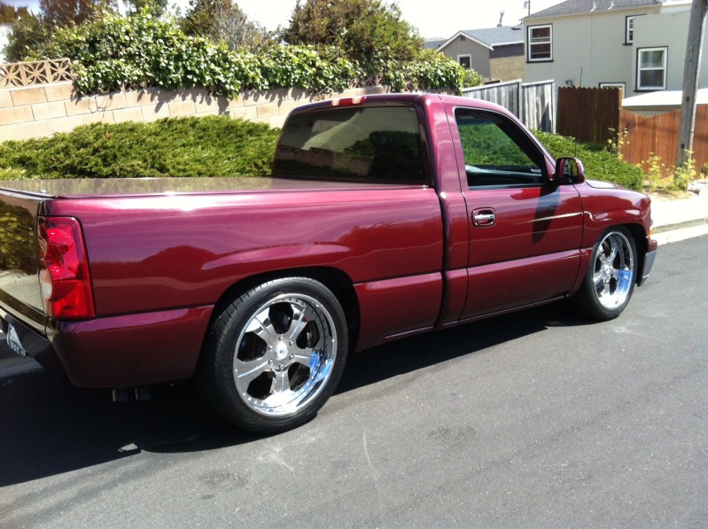

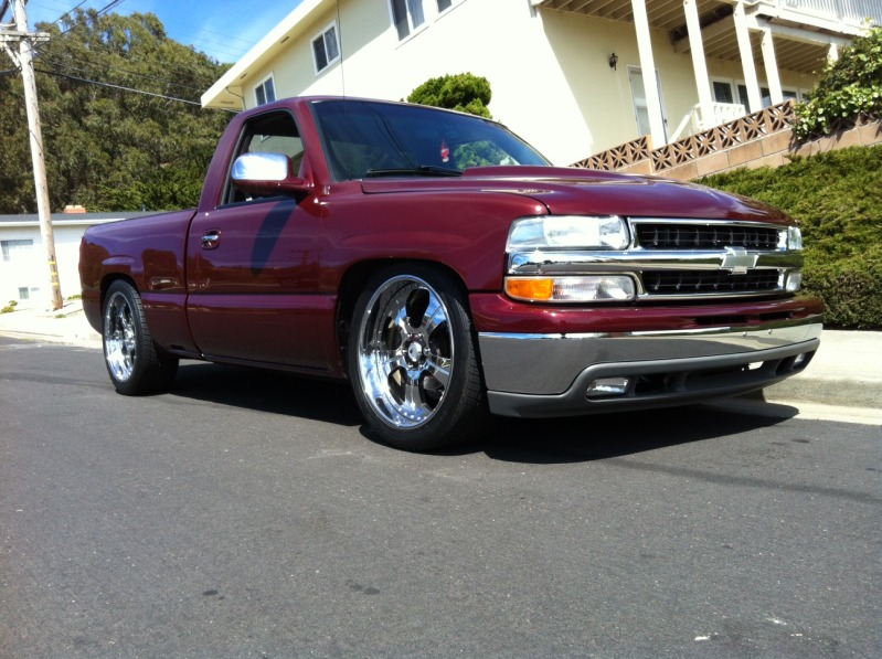

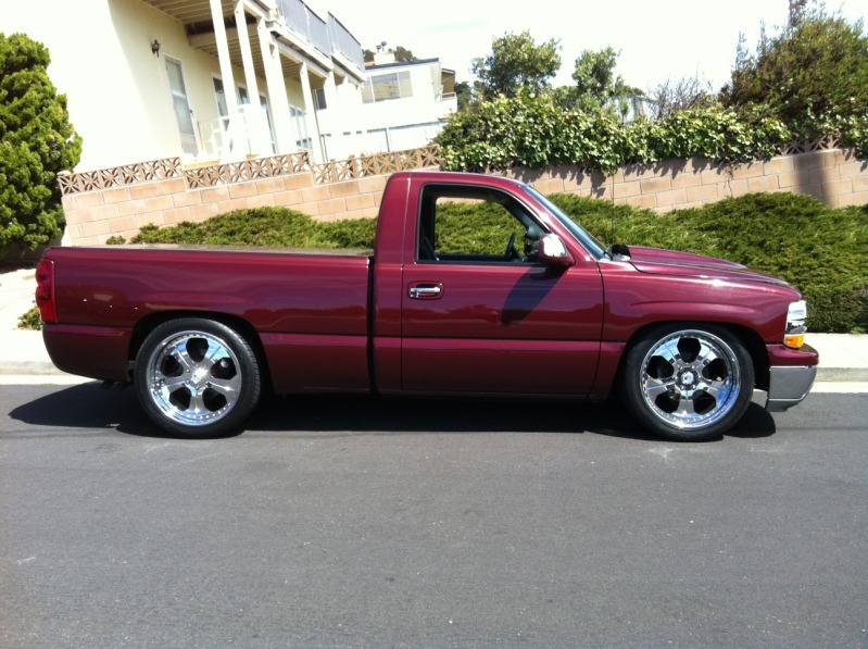

I installed DJM Upper and lower a-arms on my 4wd. Previous set up was McGaughy spindles and lowering keys for about 5" of drop. It rode horrible!!
Now I have DJM arms, McGaughy spindles, and lowering keys. Probably close to 6" of drop. The keys are almost all the way up and it is still a little too low. It rubs on going over bumps. I am going to try to crank it up a little more (if I can find my stock keys) and see where it is rubbing.
Those of you that are slammed up front, what do you do to the inner fenders?
One issue I dont have any more is the turning radius issues and binding issues. It should align fine as there is plenty of adjustment in the uppers.
Here are a couple of pics, the truck is dirty.

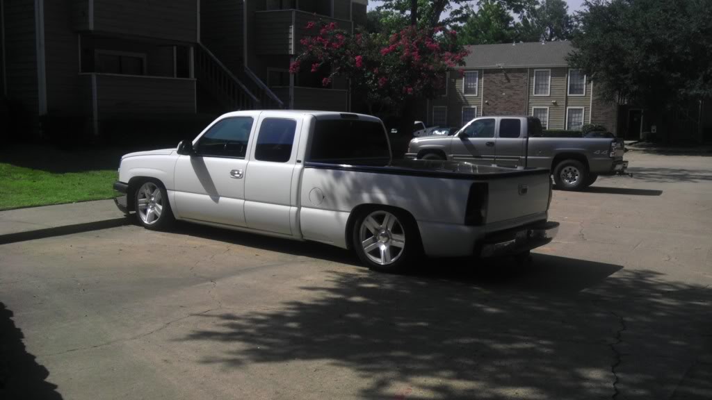

oldschoolchevy is 4x4, so is black04
