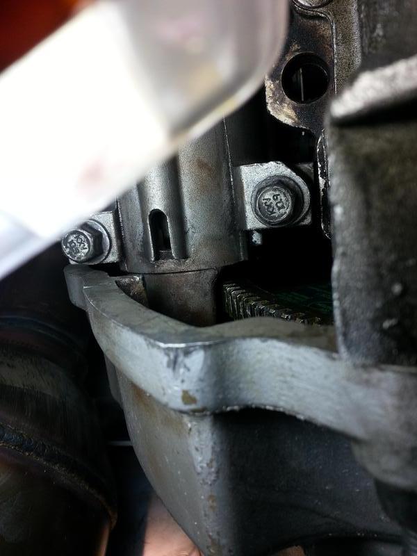

I don't know how the hell I spotted it with everything installed, but the flexplate is hitting the starter bearing in the front, where the gear comes out and stops.

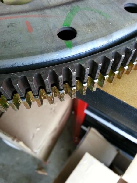

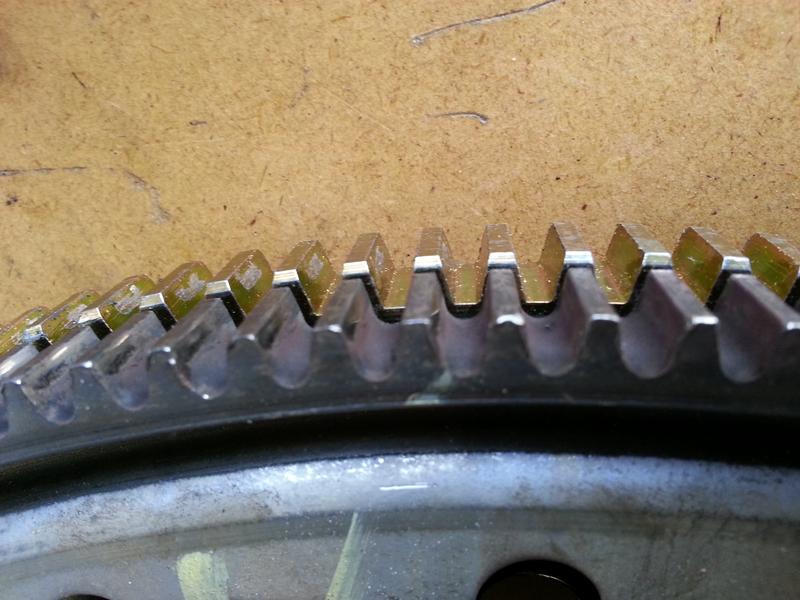

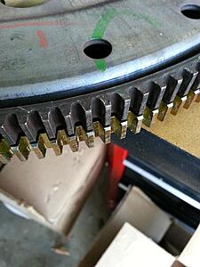

the B&M flexplate is about 2-3mm too large in diameter.
Here it is lined up with the GM plate

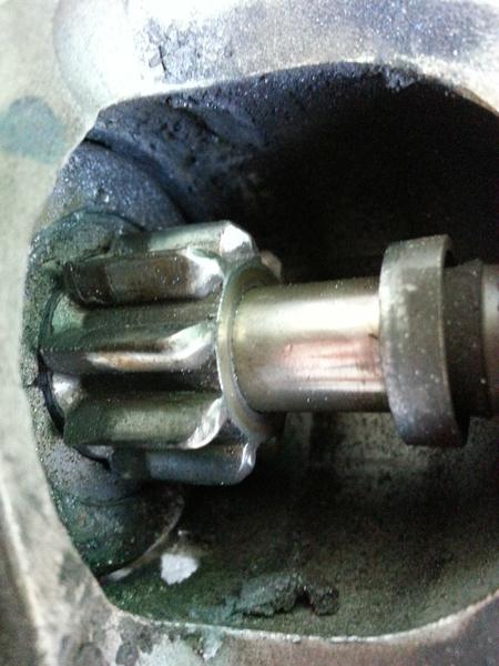

you can see here it's barely starting to wear the starter bearing on the back half

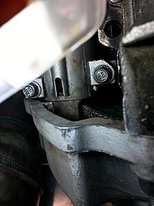

Here i where I spotted it, in the black void (cant be seen in the pic)

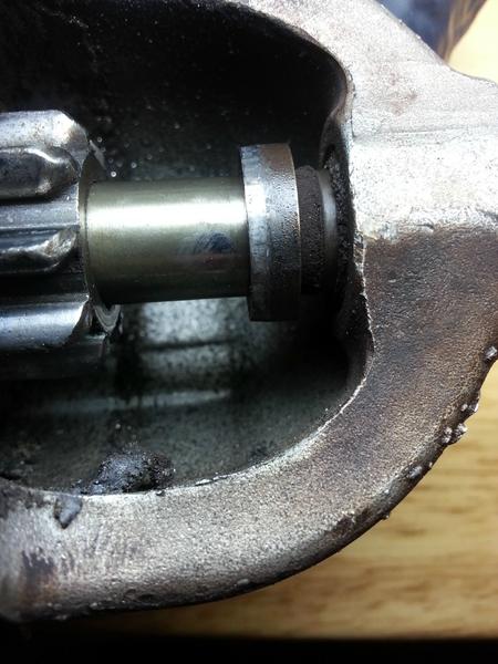

Here is the bearing more worn now. The flexplate was hammering it, not scraping it

Starter shim would fix that pretty easy.

The shims will space the starter down from the block, giving more clearence for the flexplate.

Same thing happened to me with an aftermarket flex plate. Put about .060" worth of shim in and the noise went away.

Thanks guys. I'm going to put some washers in between the block and starter for now to see how much I need to make the sound go away.

two stainless 1/16" washers and it's fixed. Thanks for everyone's help
