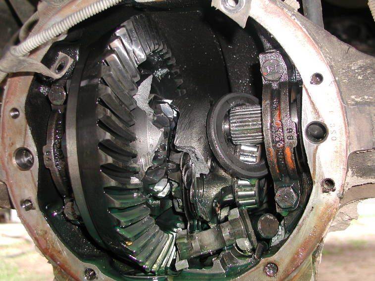

The G80 (GM's universal RPO code for limited slip; not really a "part #" as such, but, almost as good if matched with an application) is an explosion waiting to happen. In trucks, it means an Eaton Gov-Lock. Exsqueeze me, a Gov-Bomb, Grenade-lock, ... yeah, that.
It was originally designed as a solution for military vehicles with underpowered very little gas-using engines in military off-road vehicles (thimk, an armored S-10 blazer painted olive drab camo with white spots because it's winter, with a ground-pounding 31 HP John Deere diesel) that were NEVER supposed to go onto pavement, but only on very low-traction surfaces (thimk, freshly shelled no-man's-land between the trenches in central / eastern Europe after the Russkis and Krauts and Frogs and Limeys and whoever else get through pounding it with heavy artillery for a few months, then it snows) hauling the wounded. It is NOT in any way a "high performance" part. It allows a very low-power low-speed vehicle to achieve maximum traction on very slick surfaces. It is NOT meant for pavement. (have I used the word "low" enough in this context yet?)
It has a "governor" (weights on a spinning shaft that sling outwards as they spin faster) that operate a set of dogs. The way it works is, NO POSI ACTION WHATSOEVER occurs (it's an open, i.e. unlimited slip diff) until the RPM difference between the axles exceeds some threshold, somewhere around 150 RPM; and at that point, it locks up SOLID. If this happens while ANY tires have traction, it results in a loud BANG. If enough power is being applied at the moment, it dissolves into shrapnel under the instantaneous stress.
Here are acoupla pristine examples of what happens next from the Interwebz. Pretty typical, in my experience. I kinda wish a had a photo of the one somebody complained about that shot flaming red-hot metal pieces through the rear axle cover and into his gas tank. I think he had to buy new underwear afterwards, and maybe even a new front seat cover.
