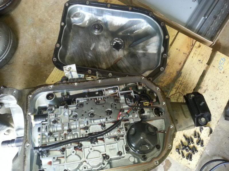

Nah I ditched the real problem and went with a transmission capable of holding the power AND GVWR and GCVWR (I tow 7,500#) ratings in 100% STOCK form. 4L80E swap with a LKQ junkyard unit also came with a 6 month warranty on the trans. Try finding a stock rebuild on a 4L60/70E from a reputable builder with a warranty for what the junkyard swap cost me.
That was the pan/magnet on my 100k junkyard 4L85E out of a 2002 Express. It has 5 pinon planets and has a very noticeable first gear.
