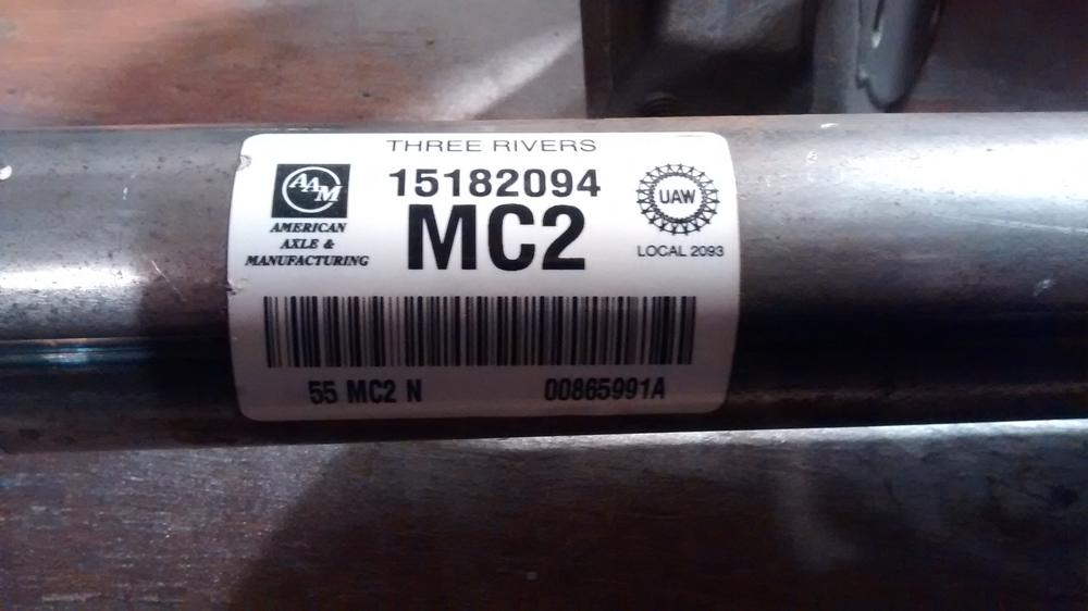

Old Aug 9, 2015 | 04:09 PM
tgui's Avatar
Joined: May 2014
Posts: 1,252
Likes: 7
From: VA
Originally Posted by SloSVO
wow.. surprised no one else had anything to say?... is there another forum that is busier than this one? There doesn't seem to be much movement here most of the time...
This question pops up quite a bit and there are some good existing threads that answer your question.
Here is the part you need. It's what I'm using for my eventual 4l80e swap.
