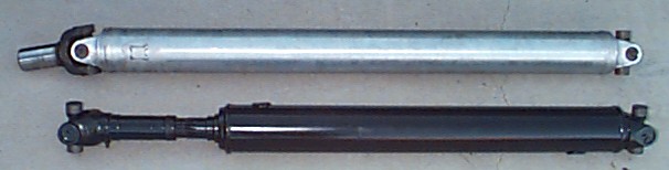

I also have a custom fabricated steel driveshaft. It's 3.5" diameter, weighs 24 pounds (heavy ****) and has fixed yokes at both ends. The shaft itself is splined.
Why the seemingly overkill for this truck? Well, I have 4.56:1 gears and have my speed governor set at 130mph . I've hit the limiter plenty of times during some WOT blasts. That's over 6600 RPM for that driveshaft. I wanted to know the driveshaft was up to the challenge.
This is it on the bottom:
