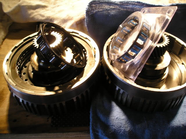

There are two roller clutches, and one sprag.....
The Intermediate sprag comes in 16 or 34 element, obviously, you want the 34 element. There are some aftermarket companies make 36 elements, but for the cost, I'd have to roll one over first....
The other two roller clutches are the overdrive roller assy, and the low roller.
Not much to do with the low roller other than INSTALL it in the right direction
The overdrive roller has two versions, the later version is the one with the blue inserts. It was some time in 2001 when the 4l80e started getting the new design roller.....
Also IF you go to a new design overdrive roller, the overrun clutch and the overdrive clutch assy will need to be updated as well.....
Here is a dark pic for your viewing pleasure...

OK, I think I'll stick to what I have then. I don't plan on abusing it in over drive and IIRC Thunder broke the sprag and did up grade it and was something crazy like 600 bucks, but I think his broke from 1-2 shift being set up to hard. I'm going conservative on my shift settings
