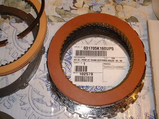

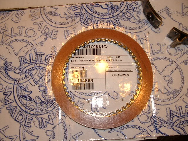

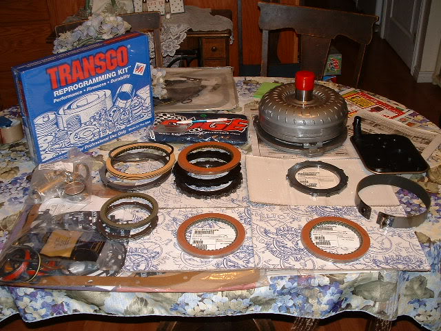

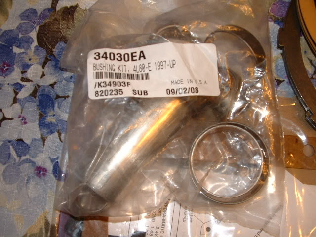

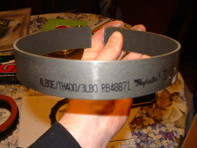

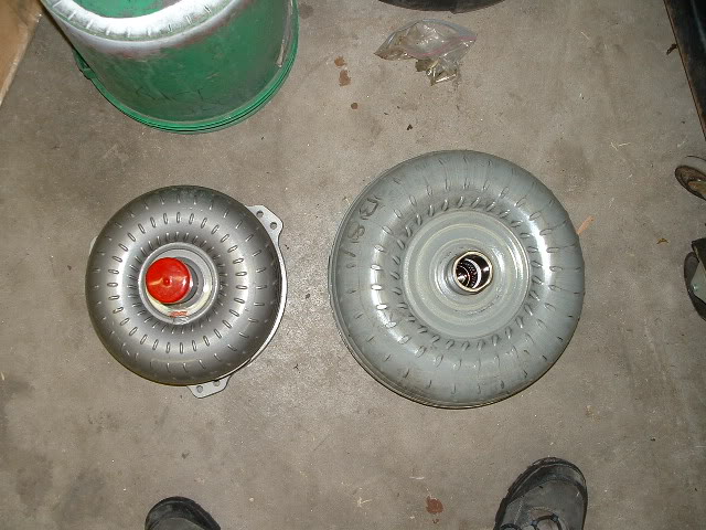

Well, I got everything for the 4L80e rebuild today. (I think, lol) The rebuild kit is custom put together with parts from several MFG by Andre At Edge. Also got one of his custom built for me 9 1/2" "Street Edge" converters. I believe he said its a 3000 stall, didn't get any paperwork with anything, so I emailed him about that. I want to know for sure what he sent me. Anyone see anything I'm Missing?

Difference between the stock 4L80e converter and the Edge

What year is the trans? I do not see a sprag, low roller, OD roller, rear band, solenoids, harness or pistons. Also the shift kit you received does not come with the valve body spacer plate. You might want to get one of those as well. Best of luck to you on your build. Vince

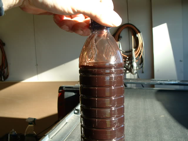

The tranny is a 2000 out of a diesel, I bought it as a good working trans and was just going to put the shift kit and run it, but then I got it home and and drained the rest of the fluid and pulled the pan, the fluid was pretty dark, but there was no metallic flakes or other trash in the pan. Also, it didn't smell burnt at all. I though it would be best to put some new frictions in there. So I'll get a separator plate, and you think I need the rest of the those parts too Vince?
