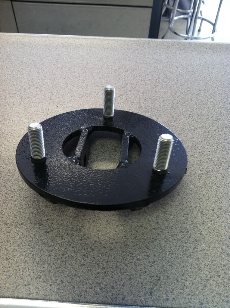

These are pics of the adapter used to mount a Pro Comp MX-6 coilover. This particular one is for a Toyota. But the same piece is available for the Chevy.

So this adapter will allow you to use a eyelet to eyelet style coilover. You just have to make a T-bar fit the lower control arm.

I like that, thank you for the info!!
