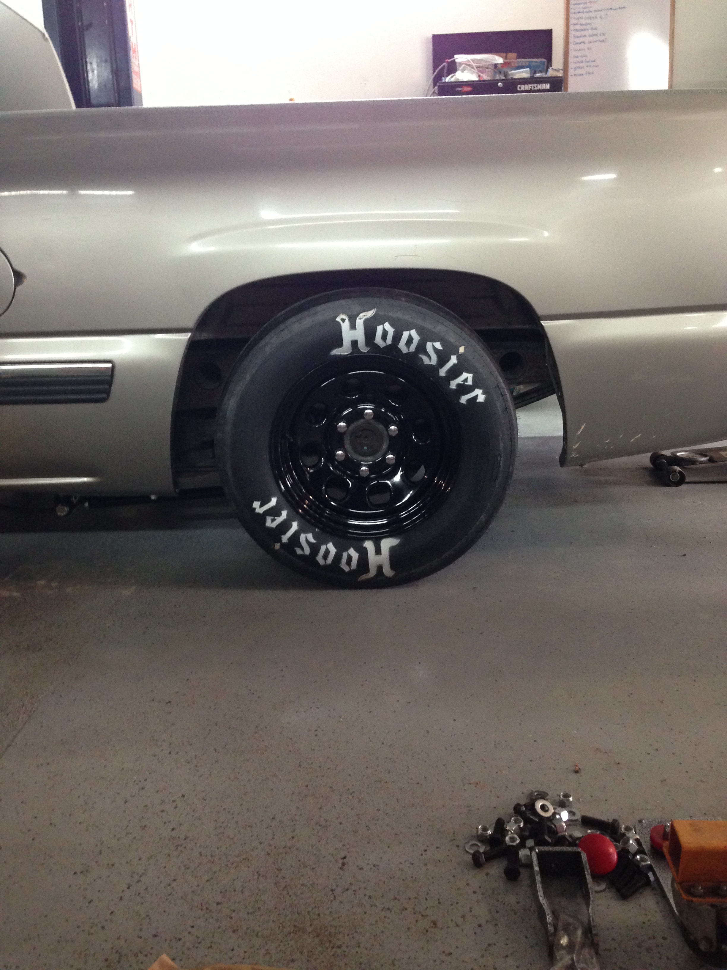

My 28" tall Hoosier didn't fit with DJM flip kit and 2" shackles. It rubbed on the lip of the bed. I'm sure it could be rolled, but with tire wrap when it hooks, I'm not convinced even the rolling would help. Like the above poster mentioned, big power is going to need a decent tire. When you get that low, say 8 inches, you're not going to squeeze anything substantial up under it. Even at 6 inches, It still worries me a bit.
Sitting on flip kit only---v
