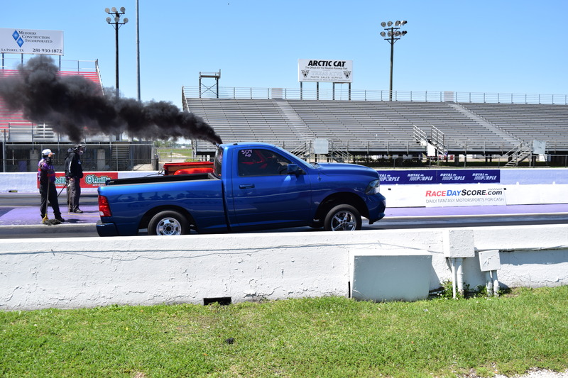

Hey guys, the Dodge section is dead here, so I figured I would post this here instead. I have a 2011 Ram, and while testing the nitrous last weekend, actually pulled the front tires a bit on the launch. The truck was hopping all over the place on the launch because of this, so I'm thinking about installing limit straps up front. Doing some research here, I'm only seeing the 4wd guys do this. Are any of the 2wd Chevy/GM guys using straps to keep the front end down?

The front of my truck lifts too high causing it to come back down, then lift again, then come back down and lift a 3rd time before finally going straight. I had some wheel hop in the rear as well, but was on a radial tire. I put a set of true slicks on it this week to hopefully cure the wheel hop out back, but I'm thinking that limiting the amount of front end travel will keep the front down and prevent it from bouncing as much on the launch.

I have adjustable coilovers in the rear and adjustable QA1 shocks up front. I have already stiffened up both the front and rear to help control the amount of lift, but I was just curious at what point any of you guys may have had to actually use straps to keep it under control. I havent had a chance to test the new shock settings yet. On that particular pass, the truck cut a 1.50 60' time even with it bouncing like it was. I think the truck has a 1.46-1.48 in it if I can make it go forward instead of up and down.
