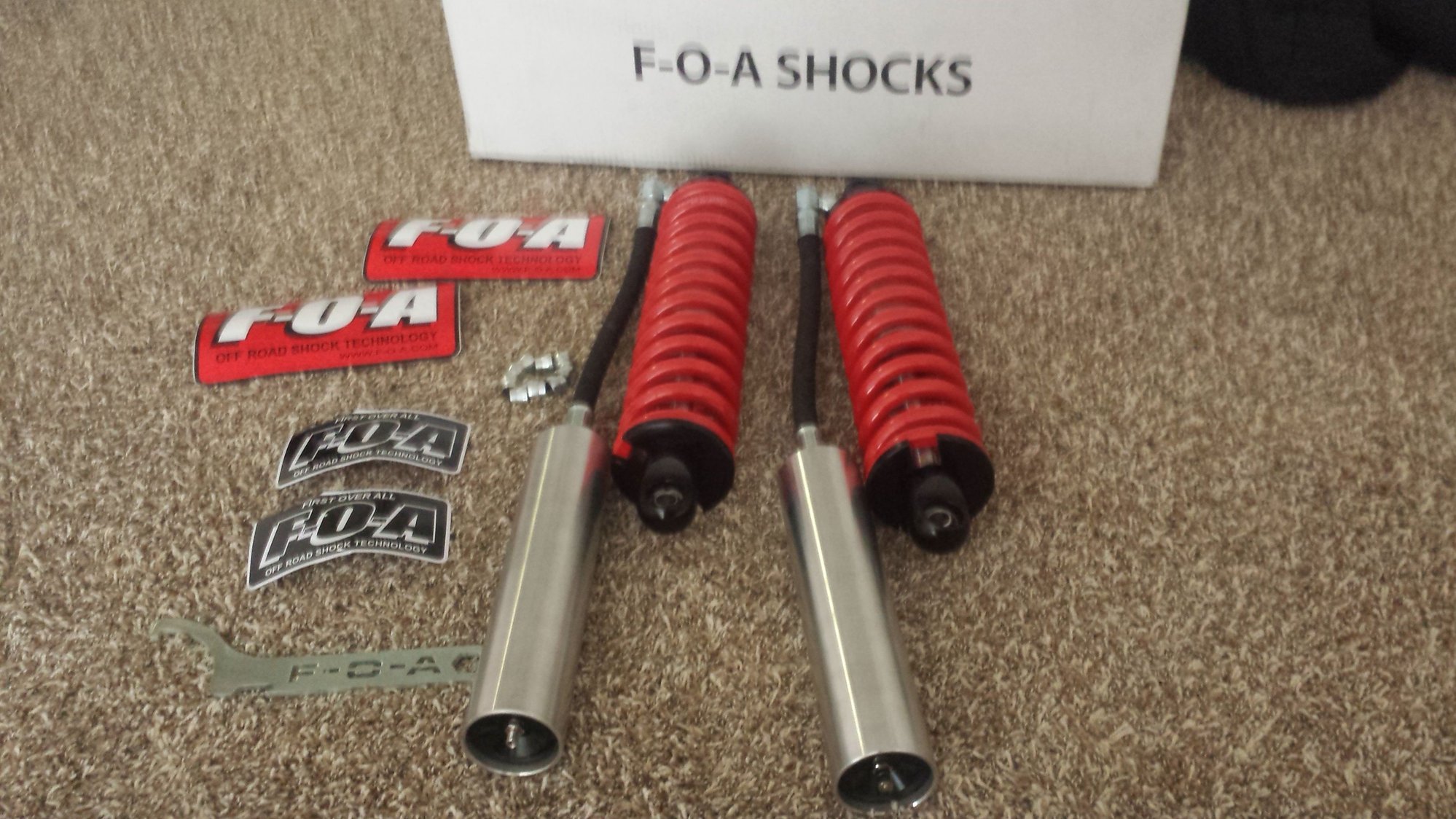

Here is everything I got from FOA
The coilovers come assembled but require you to get them charged with nitrogen. I found a machine shop down the road that filled mine to 150PSI and didnt charge me a penny but a few other places I called wanted up to $65 per shock.

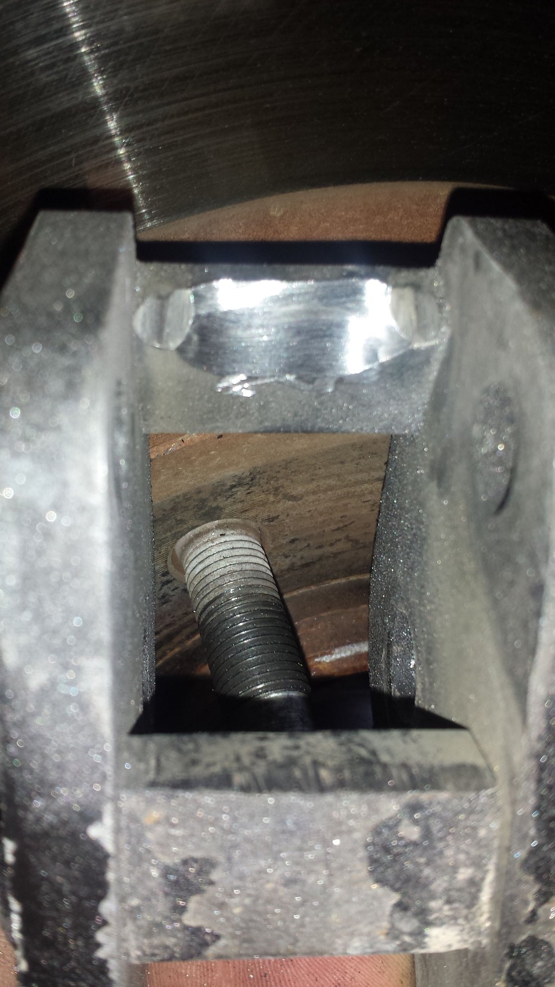

You also need to trim a little bit of the side of the top of the shock mount to make room to slide the bolt in and cut and pull the opposite side so that the nut fits.

Now begin with the bottom mount only modification needed for this is to grind a little bit of material away so that the eye of the shock doesnt rub and the bolt lines up easier.
Doesnt take alot I used a dremel

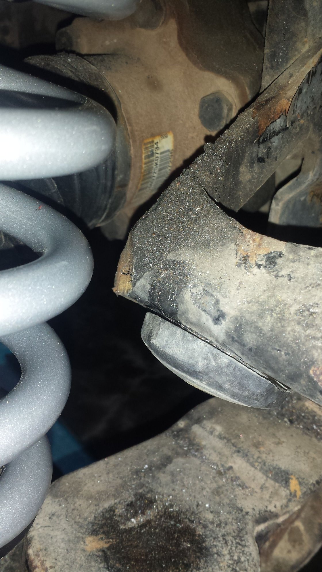

Heres how much trimming I did but depending on the lift Im sure it will be different.

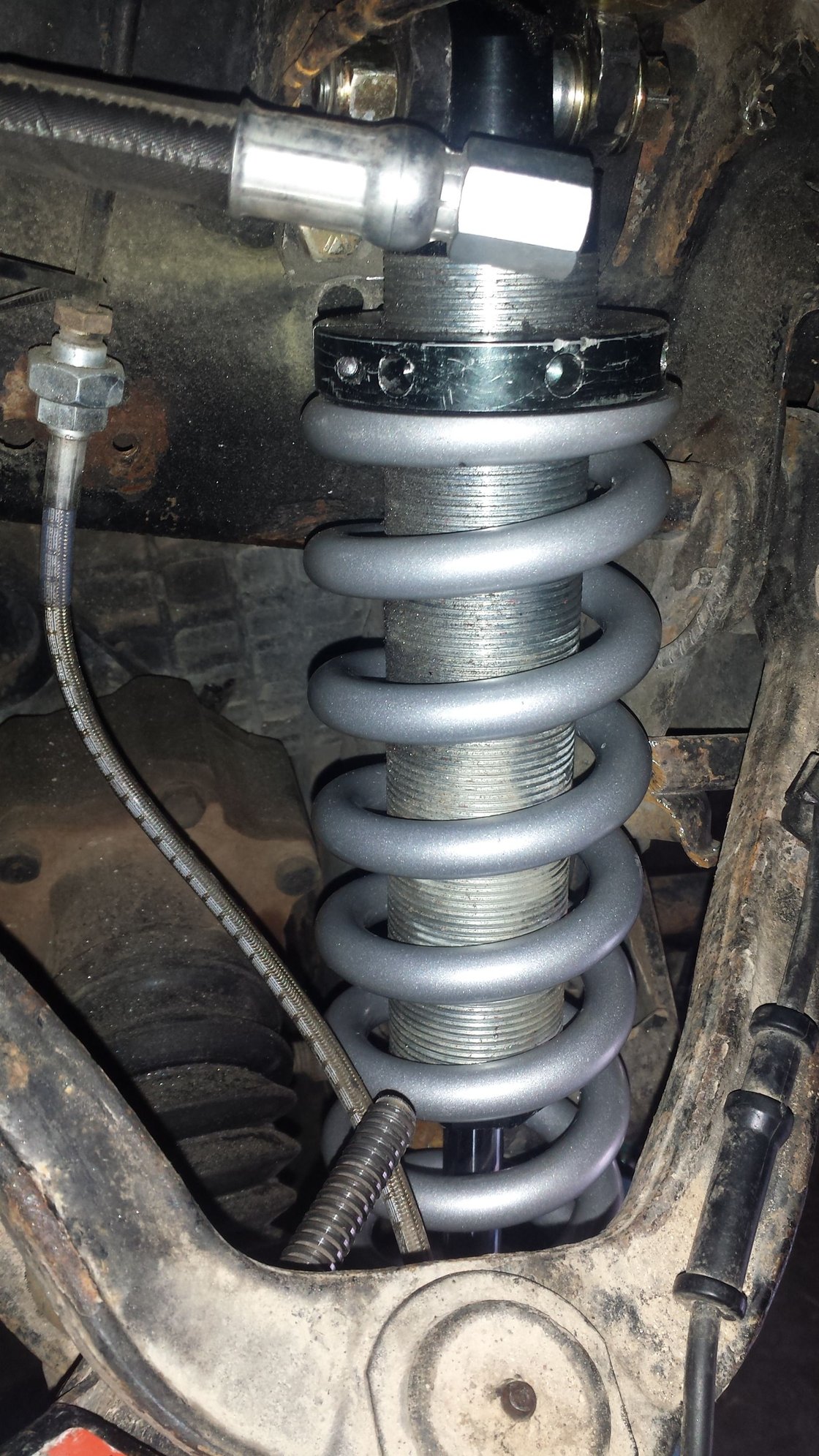

Finished product on driver side

You may notice the truck is sitting very low or lopsided don't worry thats the last step. To adjust hieght you must adjust the preload on the spring tightening the spring adjustment nut will raise the vehical and lossening it will lower it. Make sure when you do this that you spray some lube on the threads of the shock to make it easier and that you lift the weight off the suspension. Take your time and keep adjusting till you think you have it just right then go for a drive! Take it easy at first listen for weird noises go do some full and complete turns to make sure nothing is rubbing and then go back home and remeasure both sides. The springs will probably have settled a little and may need adjustment.
